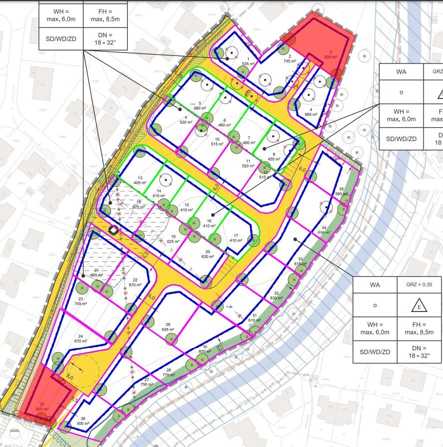

Limbrandi10 Apr 2024 13:55Hello everyone,
Today we received feedback from the city that we will be assigned a building plot.
The procedure is exactly the same as for the first development area.
We will be called to the decision appointment and then can choose from the remaining available plots.
This time, the development area better meets our wishes regarding connectivity and flatness.
The city has offered us a consultation appointment next Monday. During this meeting, the development plan requirements will be reviewed, followed by a discussion of the pros and cons of any plots we may have already selected.
Our requirements remain similar to before, except that we have now agreed to build without a basement.
We are open regarding the house shape, although we lean towards a rectangular design.
The terrace should again face south to south-west and ideally have little to no slope.
Since all the plots in this area tend to be larger than in the first development, we have no problem with a somewhat bigger building plot due to the many advantages.
The two outer plots marked in red are up for bidding.
The green plots are 20€/m2 (about $20/ft2) cheaper than the purple ones.
We would again be interested in which building plots would be the best choice based on the above points and what advantages and disadvantages each plot carries.

Unfortunately, you have not yet understood some essential points, which is very unfortunate:
Both image sections you chose cut off crucial information – we cannot advise you like this! Please show the two usage templates; we cannot properly compare them if they are so incomplete.
In the "bauplatz" image, contour lines are visible, which are covered by the colored lines in the "bauplatz_" image. These lines are crucial for determining which template applies to the left and which applies to the right side of the plan. Also, only in the "bauplatz" image – faint but still present – are elevation lines visible.
Please specify for which plots the left and right template applies, and which elevation line is closest to the center of each plot as well as its neighboring plots on the right and left. Keep in mind...
… this is not just your private decision. Should I remind you of my basement formula every month? (Don’t forget: it is almost a "law of nature"; I merely formulated it.)
