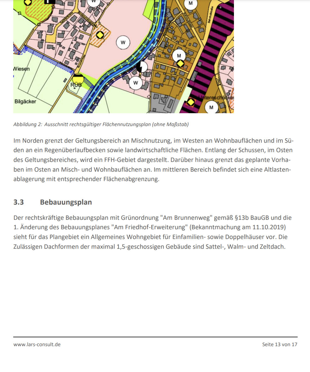

Limbrandi13 Mar 2024 22:42Good evening everyone, I wanted to briefly update you on this. We adjusted our placement since the original development area didn’t fully meet our expectations.
We are now considering a neighboring town that currently has a development area in the application phase. This new area offers significantly flatter plots, and the connections to bus and train, as well as shopping facilities, daycare centers, and schools, suit us better.
In any case, we are back in the application process and have a few questions regarding the regulations in the development plan. Under the section on energy supply, district heating is recommended— is this mandatory? At the same time, geothermal probes are prohibited due to water sources. Would a heat pump therefore be forbidden?
What options do we have regarding energy supply?
In the latest amendment "Am Brunnenweg," on page 13 of the development plan, it states that buildings may have a maximum of 1.5 storeys. Does this mean that two full storeys are not allowed?
The development area is managed by the municipality of Wolpertswende, "Am Brunnenweg."
Limbrandi schrieb:
Anyway, we are now included again in the application and have a few questions about the regulations in the development plan.
Under the section on energy supply, district heating is recommended—is this mandatory? At the same time, geothermal probes are prohibited due to water sources. Would a heat pump then be forbidden?
What options would we have regarding energy?
And in the latest amendment "Am Brunnenweg," page 13 of the development plan, it mentions a maximum of 1.5-story buildings. Does this mean that two full stories are not allowed?
The building area is from the municipality of Wolpertswende "am Brunnenweg." I only see under 9.5 "Heat supply" (p.54) a mention of biogas and no details about the number of stories, but a wall height limit of max. 6.0 meters (20 feet) and a ridge height max. 8.5 meters (28 feet) with roof pitches between 18 and 32°—which are typical values for a townhouse style.
hanghaus202314 Mar 2024 09:12Limbrandi schrieb:
District heating is recommended under the energy supply section; is that mandatory?If the purchase contract does not include a specific provision, this is only a recommendation.
There are also heat pumps without ground-source probes.

Limbrandi14 Mar 2024 09:1911ant schrieb:
