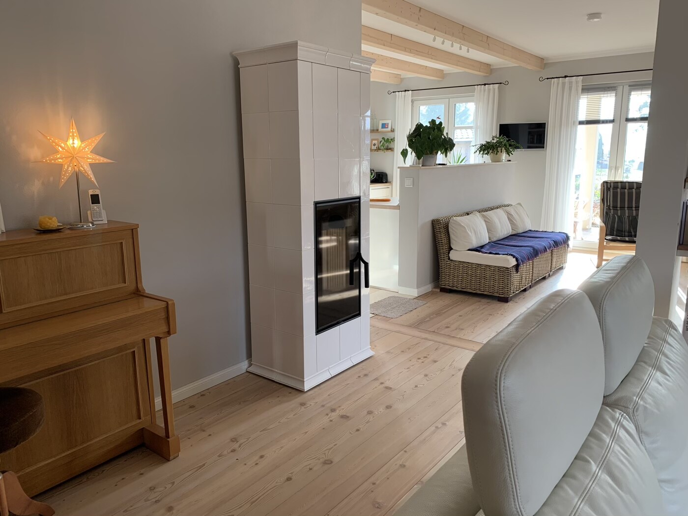

We also have a wood-burning stove that mainly serves to create a cozy atmosphere. It is from the Czech brand Hein-Ofen. Our stove fitter from the local area installed it. Including delivery and installation, the cost was 4700 EUR. Maybe you would like something like this?

The installation was carried out by the seller’s partner/tradesperson (specialist stove retailer).
Steffi33 schrieb:
We also have a wood stove, which mainly serves to create a cozy atmosphere. It’s a Czech brand called Hein-Ofen. Our stove fitter from the region installed it. Including delivery and installation, it cost us 4700 EUR. Maybe you’d like something like this?
Don’t you have a hearth pad? Was it possible for you to install it without one?Similar topics
