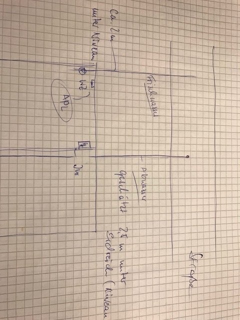

_Michael_ schrieb:
I roughly sketched it out in the attached file ...
The basement is to be completely excavated, backfilled, and compacted for the foundation slab ...I don’t see any attachment. My question was aimed at understanding what advantage the deep demolition is supposed to have or whether the basement is causing issues: even if it is too small, misplaced, or too high, deep demolition is not always the most practical solution.https://www.instagram.com/11antgmxde/

_Michael_15 Mar 2021 19:0811ant schrieb:
I don’t see any attachment. My question was aimed at understanding what advantage a deep demolition would have, or whether the basement is causing an issue: even if it is too small, incorrectly placed, or too high, deep demolition is not always the most practical solution.I wanted to attach a PDF ... it’s not accepted ... let’s see if a JPG works ...Well, it probably wouldn’t be much of an obstacle if part of it remains and the rest is filled in. It will likely affect the cost, but the connections are still in the way ...
