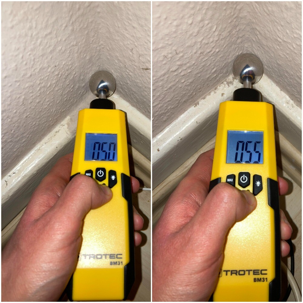

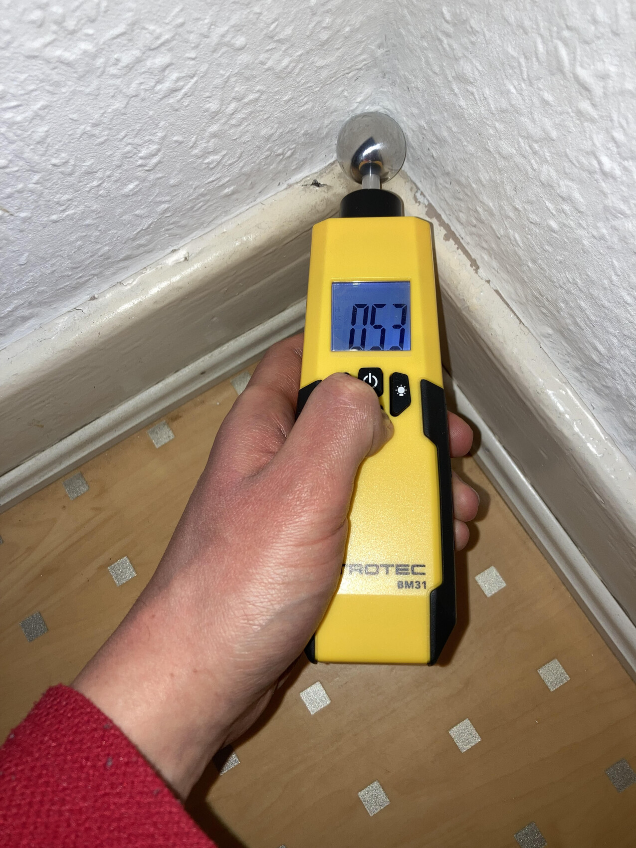

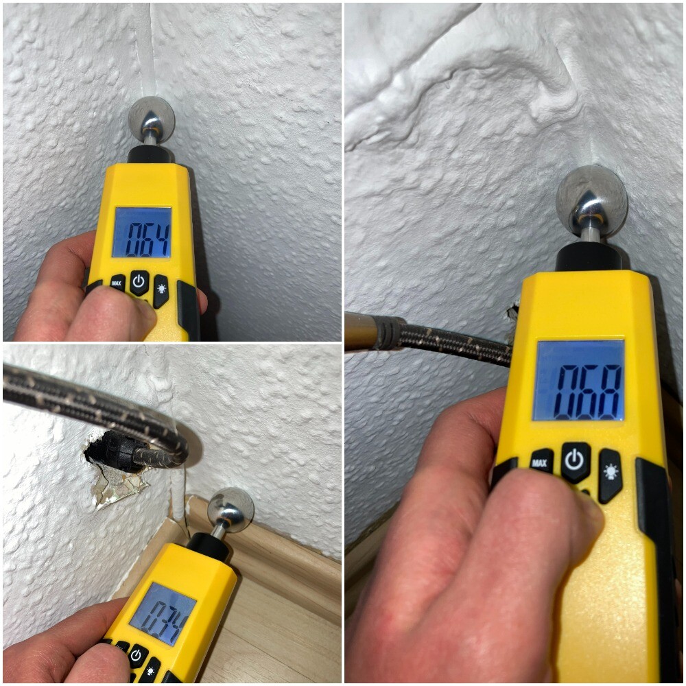

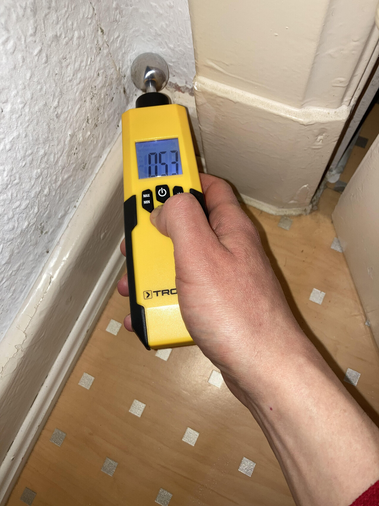

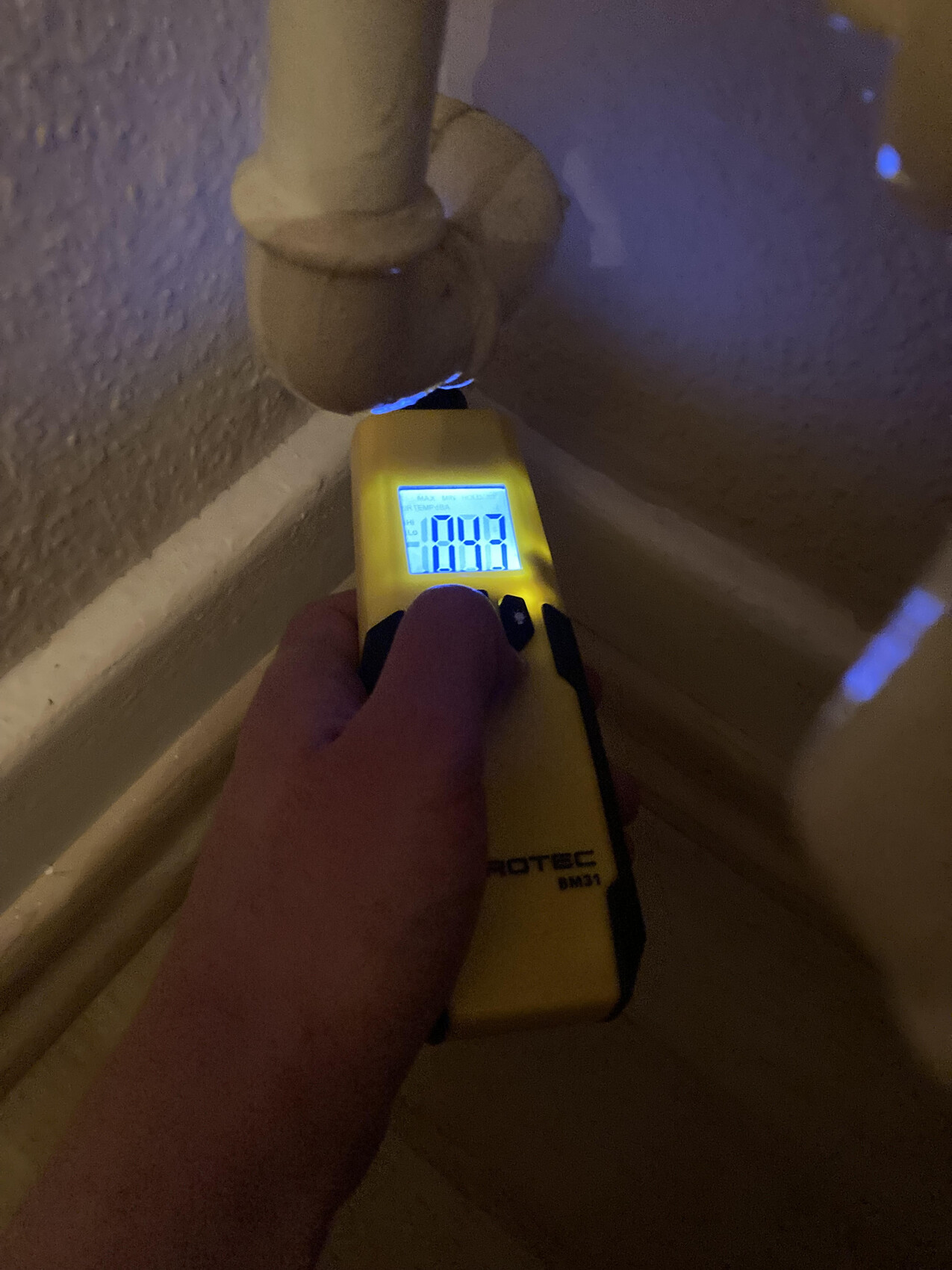

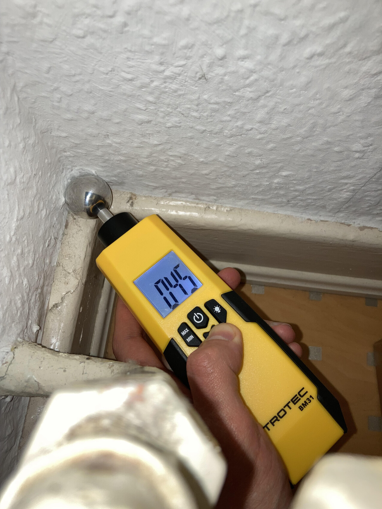

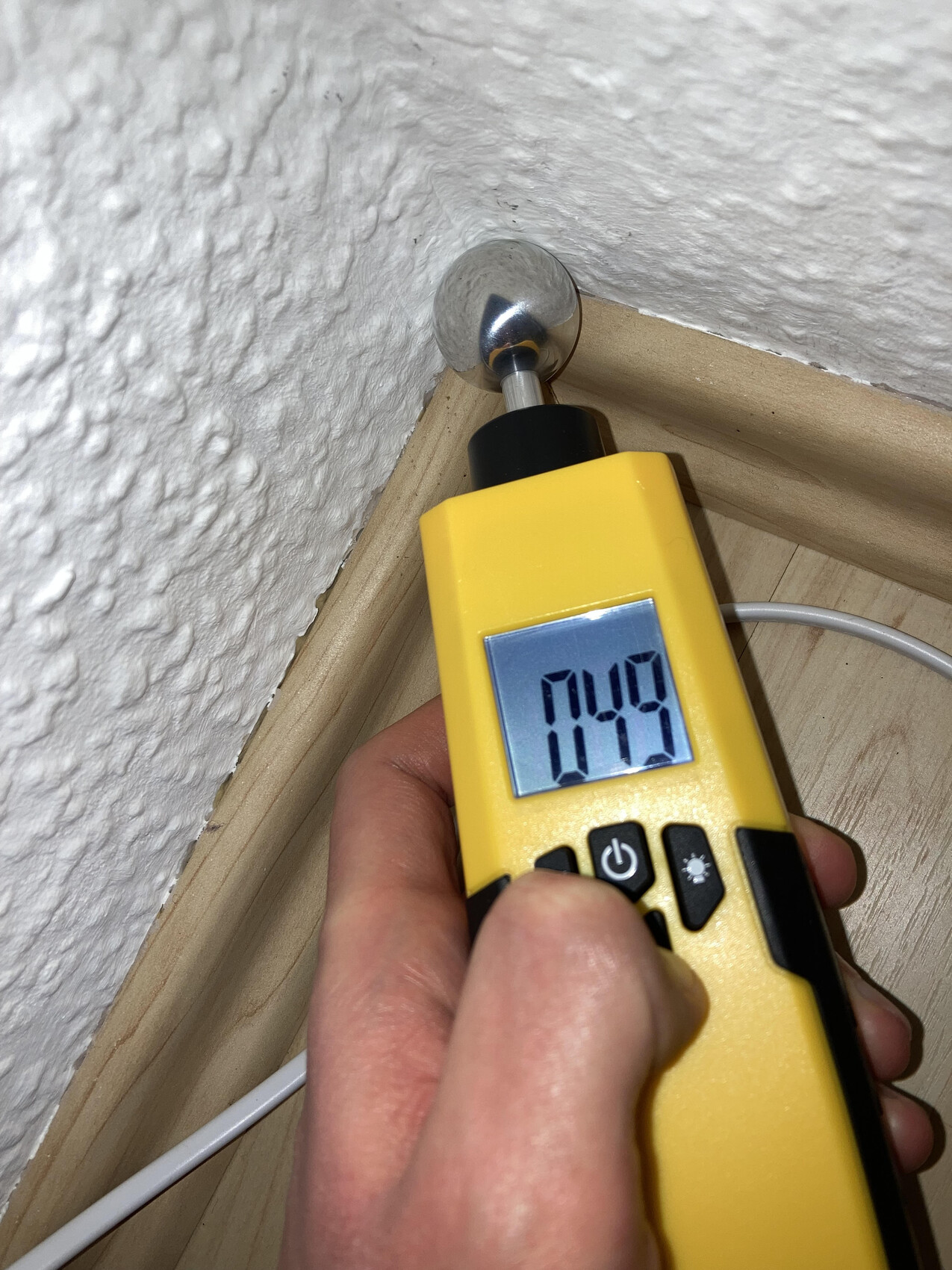

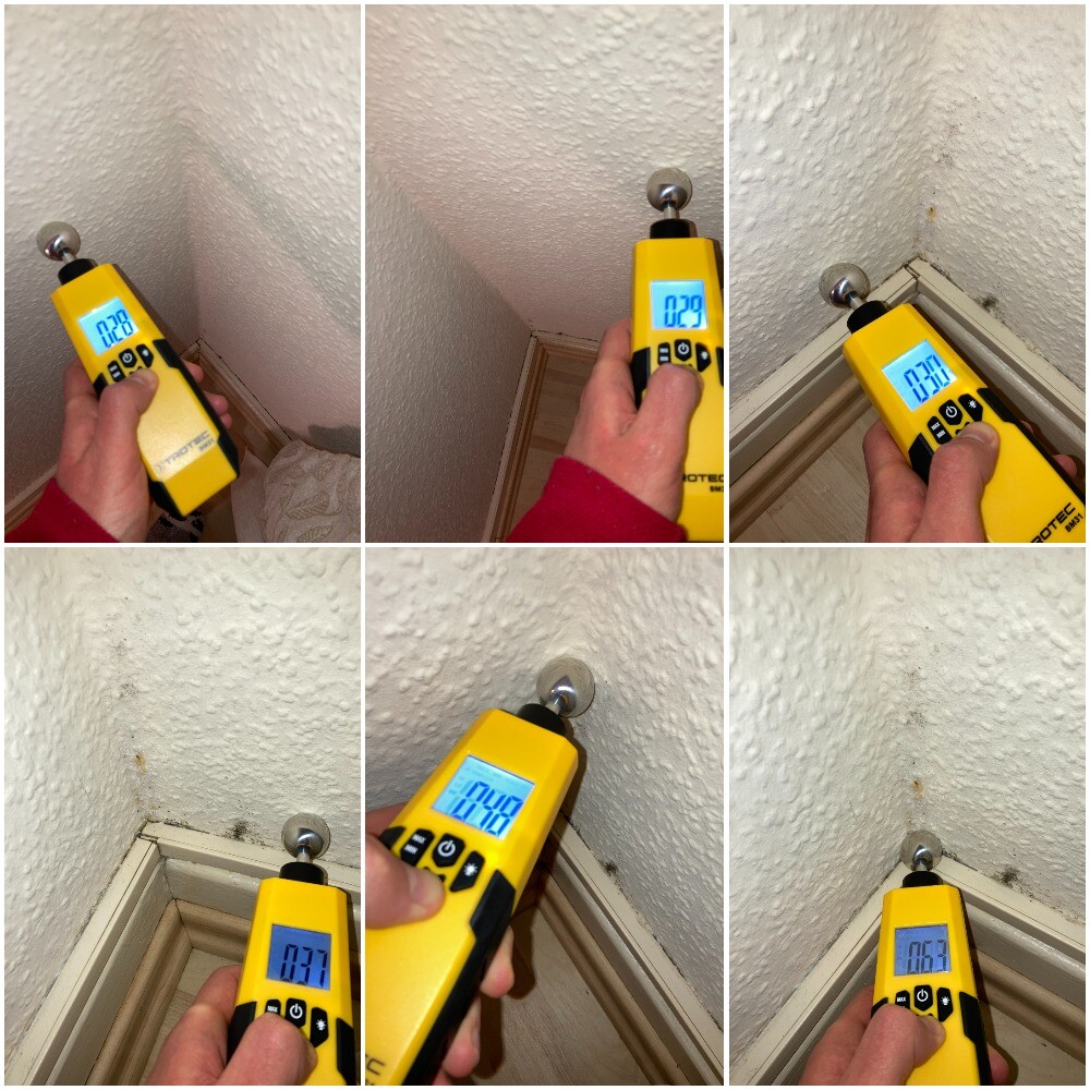

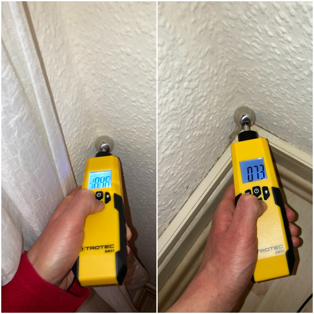

I made an effort and took some measurements regarding moisture and thermal bridges. I definitely need your help interpreting these. For moisture measurement, I used the TROTEC BM31, which shows moisture not in percent but in dimensionless digital values. In the mold corner, the moisture is very high only in one spot—in the actual corner itself. The highest moisture is in the corner of the same room (bedroom) on the same exterior wall, but where there is no mold yet (though maybe it could appear?).
I hope the photo filenames give a reasonable idea of the locations. If not, I would be happy to answer questions.

Benutzer20023 Jan 2022 15:31SoL schrieb:
At 20°C (68°F) and 60% humidity, the dew point is 12°C (54°F), which is above the surface temperature of your walls in the kitchen and bedroom. This means that water will condense on your walls, making them damp and creating an environment for whatever is floating in the air (e.g., mold spores). @karambol: Just search for "dew point calculator" on Google. The first result will give you a dew point calculator. Then you can understand @SoL’s explanation.
Your bedroom always gets quite humid overnight. This is unavoidable with two people sleeping in the room. With cold walls, this practically guarantees mold growth.
Gecko192728 Jan 2022 09:17Your apartment looks like an older building. What can the landlord do about mold here? Insulate the facade on your apartment itself? Apply a fungicidal paint on the walls?
As mentioned before: Heating more -> room temperature rises -> relative humidity decreases because warm air can hold more moisture.
If your humidity stays the same because you think "if we heat more, we can ventilate less," you will actually make the problem worse. The dew point rises, so condensation on the walls will occur not at, for example, 12°C (54°F) but already at 13°C (55°F).
Possible options:
- Breathe less
- Remove houseplants
- Ventilate more
- Heat more (and do not ventilate less while doing so)
- Get a dehumidifier with a hygrometer and run it continuously
- Install (or have installed) a ventilation system
- Move out

WilderSueden28 Jan 2022 10:14Read this: https://www.hausbau-forum.de/threads/scheiben-bei-kalten-Außentemperaturen-innen-nass-ursachensuche.42269/post-550621
I believe the issue of the dew point is likely the cause and solution to these problems. The awkward placement of the radiators is, of course, an additional factor.
