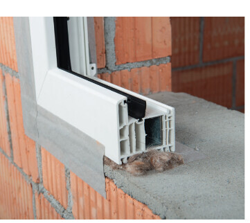

The wind barrier tape is applied to the window frame and then attached to the wall* (usually with a type of mounting adhesive). The wind barrier tape covers the joints around the window. It is also called sealing adhesive tape!
Close-up of a white window frame profile in a brick wall during shell construction

Breathable sealing tape for protection against driving rain...
profil65
31 Jan 2023 13:10
...and as a temporary UV protection, for example for expanding foam before, for instance, an external wall insulation system (EWIS) and/or render is applied.
However, with 3D compressed sealing tape, this is (actually) not necessary.

Is a driving rain barrier necessary in combination with compressible sealing tape or not?
(I, as a layperson, would have said yes, but I would also assume that compressible tape is “airtight” in terms of air and wind tightness. Since the compressible tape is installed deeper than the frame, a driving rain barrier does make sense.)
