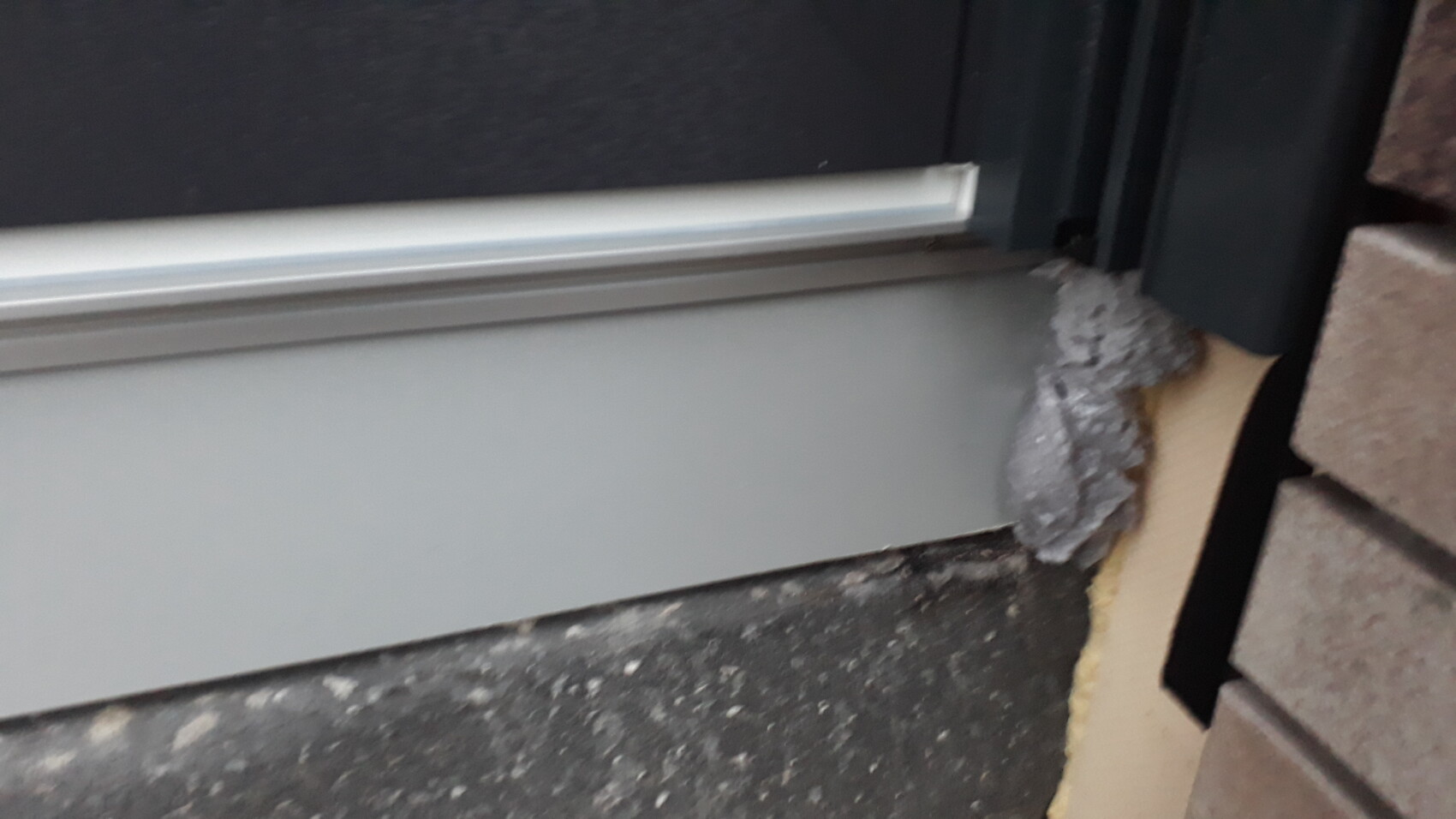

I was at the construction site after work today. The window installer started today. I haven’t spoken with him yet, but I believe from his side the exterior work is done. He pointed out the base sealing to me beforehand.
Next up would be the roofer.
What needs to be considered here? Do a few bricks need to be removed? I saw some recessed areas like that on a few. How should this be handled?
