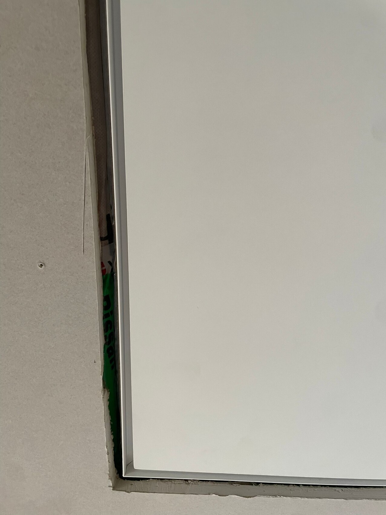

makst0wer15 Oct 2024 09:27Hello everyone,
We are currently building a KFW40 single-family house. Recently, a branded attic ladder was installed.

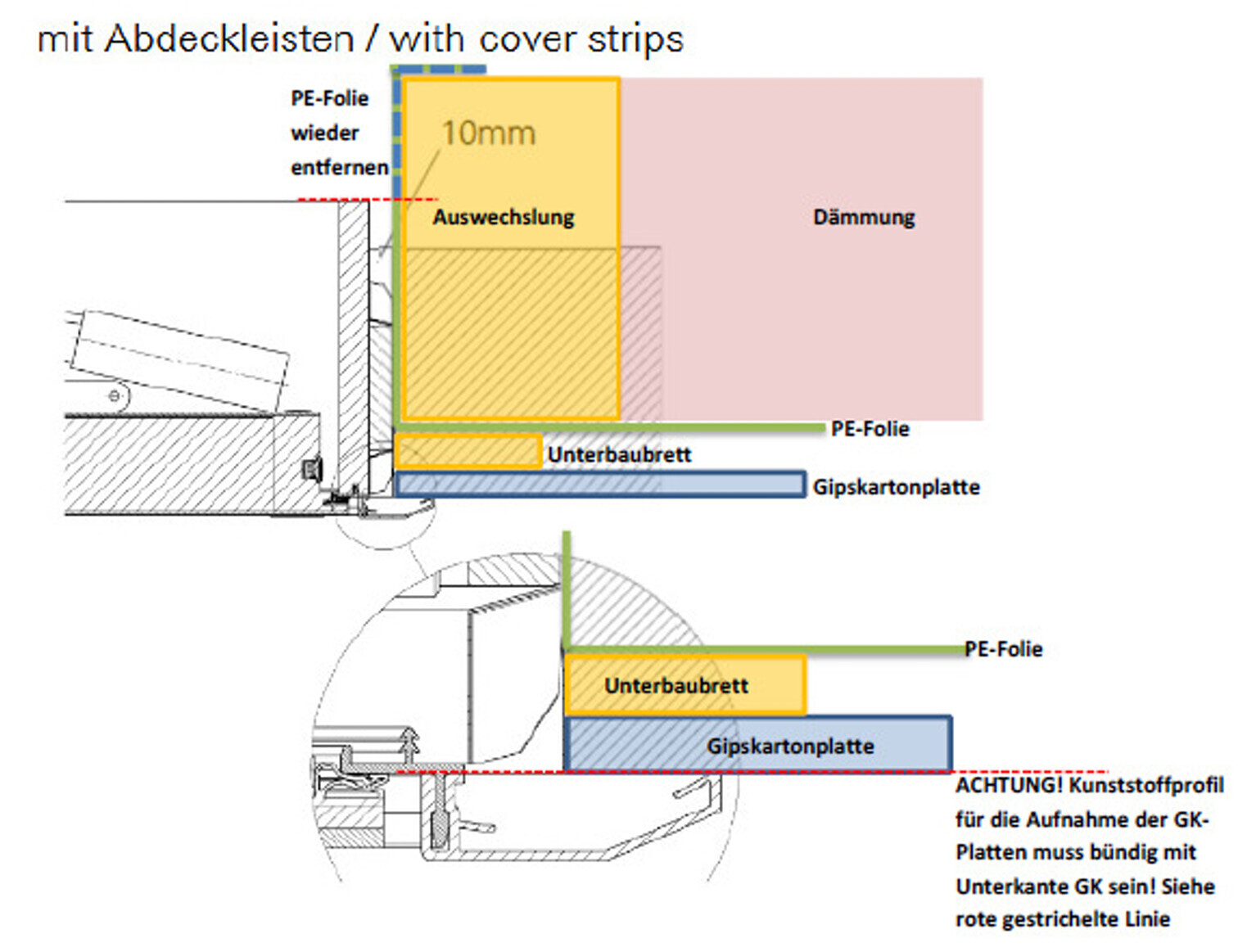

The ladder already includes an installed "insulation pad" to ensure an airtight installation. Accordingly, the vapor barrier is not glued or otherwise attached to the ladder frame.
The installation was carried out as follows:
We are now wondering if the gap/cutout should still be sealed with foam or something similar. According to the site manager, only the trim will be installed here, and that’s it. However, warm air could continuously rise between the gypsum board and the vapor barrier. I already assume that this shouldn’t be a technical problem, but wouldn’t it still be advisable to seal it, for example with PU foam, and then cover it with the trim?
