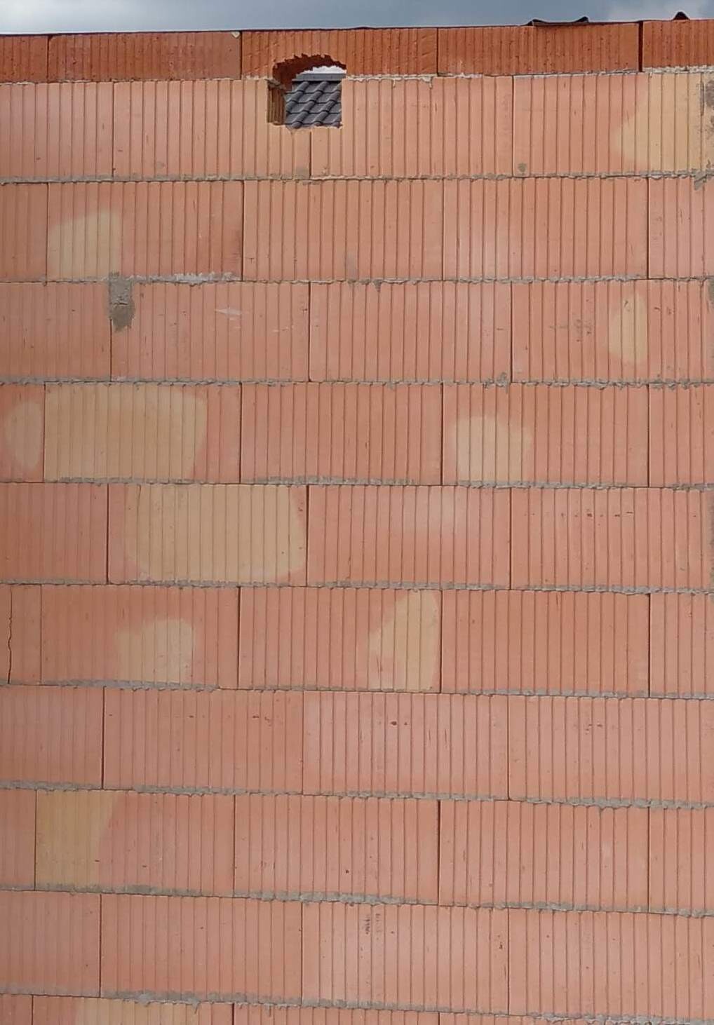

our exterior wall consists of 17.5cm (7 inches) bricks plus 17cm (7 inches) external thermal insulation composite system (ETICS).
Today, the wall was built with bricks. I asked the craftsman to make an approximately 15cm (6 inches) hole for the kitchen exhaust pipe. I planned to order the Naber E-Jal 150 wall box including the THERMOBOX afterward.
Questions:
- I am a bit unsure if this is the right approach. Should we wait a bit and use core drilling later instead?
- The hole does not look perfectly round (see picture). What is the best way to seal the pipe? According to the Naber installation instructions, using PU foam is not allowed because it presses against the pipe.
- When is the best time to install this system? There will still be ETICS, plaster... How was it done in your experience?
I know it’s not common to install exhaust ventilation during new construction nowadays. We cook very intensively, so we would like to have it.
THANK YOU for your help.

immermehr schrieb:
I know it's uncommon nowadays to install exhaust air ventilation in a new build. We cook very intensively, so we would like to have it.
Exhaust air ventilation is completely normal. Naber exhaust systems are even partially suitable for passive houses – the simpler versions also easily pass the blower door test.
immermehr schrieb:
According to the Naber installation manual, using PU foam is not allowed because it presses against the duct.
I know when DIY solutions like yours use expanding foam for insulation. The proper and correct way would, of course, be a core drill hole and compressible sealing tape or something similar.

Hello everyone
The bricklayer put a lot of effort into cutting with the angle grinder. It could have been worse.
I would suggest doing a core drilling at the end. It costs 100 euros.
The bricklayer should close it up again. But properly. Use 3 new bricks. Give him 20 euros.

Hi Steven,
can I leave it as it is and later expand or adjust exactly at that spot with core drilling if needed?
