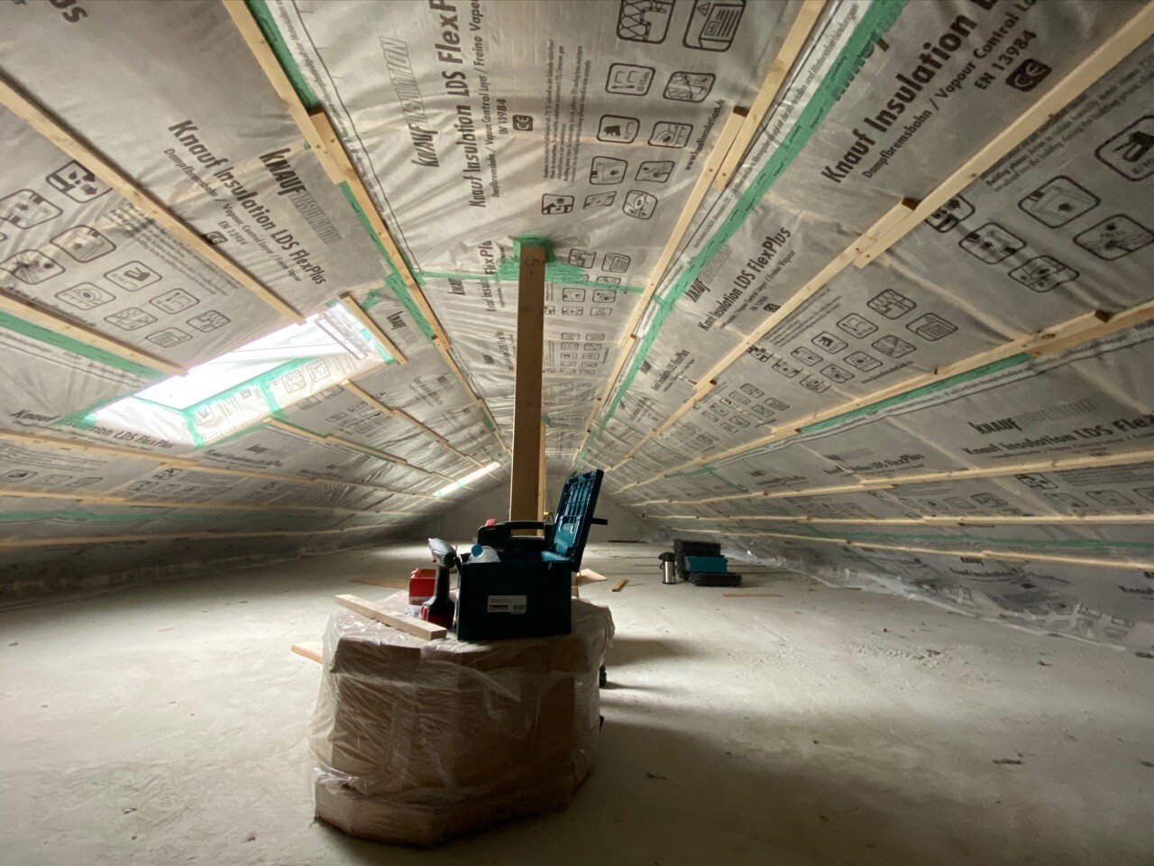

Above the upper floor, we have a concrete ceiling with an attic space above it, which we would like to use for storage. We are now looking for a simple and affordable way to seal the concrete ceiling, mainly to reduce the dust up there.
What would you recommend?
(Preferably doable as a DIY project, otherwise we will hire someone)

Mottenhausen30 Oct 2019 14:16Sweep up the loose dust and then apply a primer once or twice; that should be sufficient.
In a storage room, there isn’t much floor stress that would cause the surface to break down or come apart again.
Otherwise, the cheapest PVC flooring available online starts at 2.99€/m² (depending on offers from stores like Roller, Poco, and similar). This way, you have a durable solution and can clean it properly when needed.
