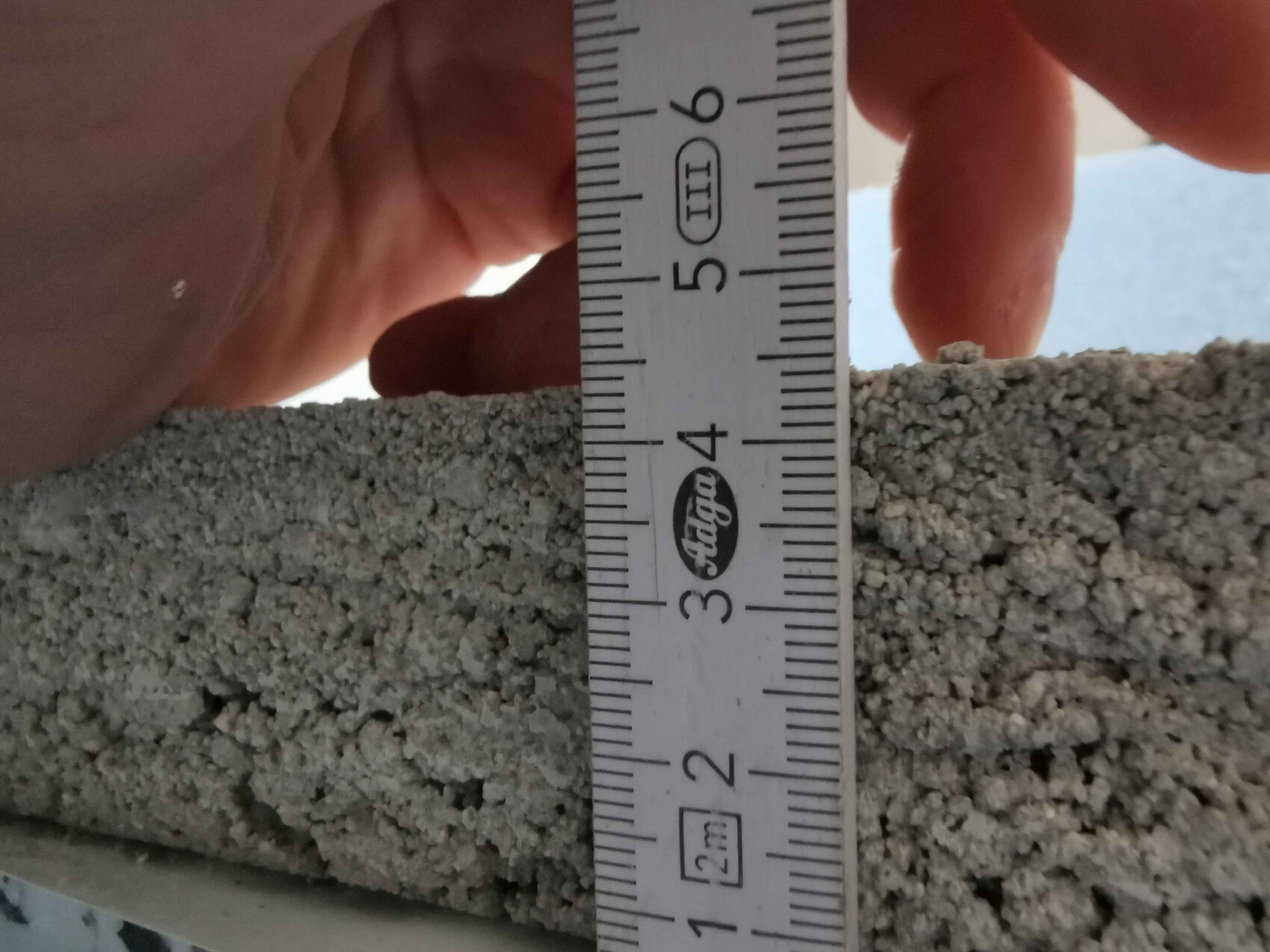

The situation is as follows: We are building a single-family house with a general contractor on a slab foundation. It’s not completely turnkey, but the screed is still the responsibility of the general contractor. On the slab, there is insulation (polystyrene boards), on top of that the underfloor heating is installed, and the cement screed was poured over it. There is no screed under the shower tray. I could see the side and measured the total screed thickness at only 45mm (1.8 inches). However, the relevant standards specify that the screed must be 45mm (1.8 inches) above the heating pipes, so we definitely have too little thickness.

What exactly are you looking at there? Are you installing a shower tray? Yes, a shallow shower pan will be installed, so I can look at it directly from that angle. Here is a photo from the perspective of the shower pan.
