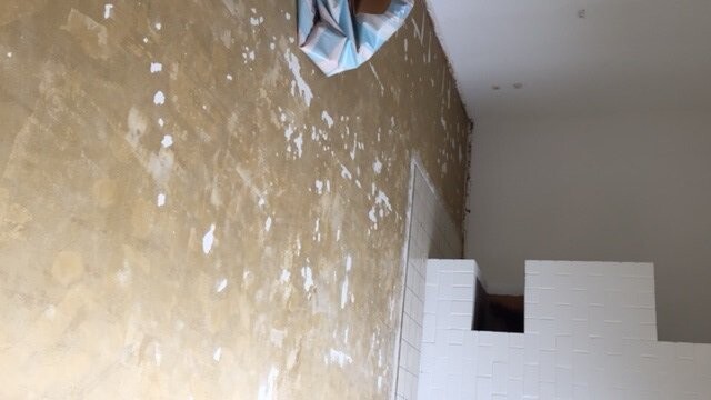

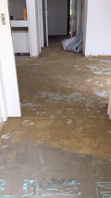

So far, only the laminate flooring has been removed (which had been installed specifically for sale purposes).

Yes, that’s exactly what I feared... the screed is practically ruined already, even though it’s hard for me to accept. It looks like we’ll have to go with the larger tiles (I’ll just have to live with the narrow grout lines). I don’t want it to turn into a cheap or makeshift solution—I know myself and us well enough for that; buying cheap means buying twice.
