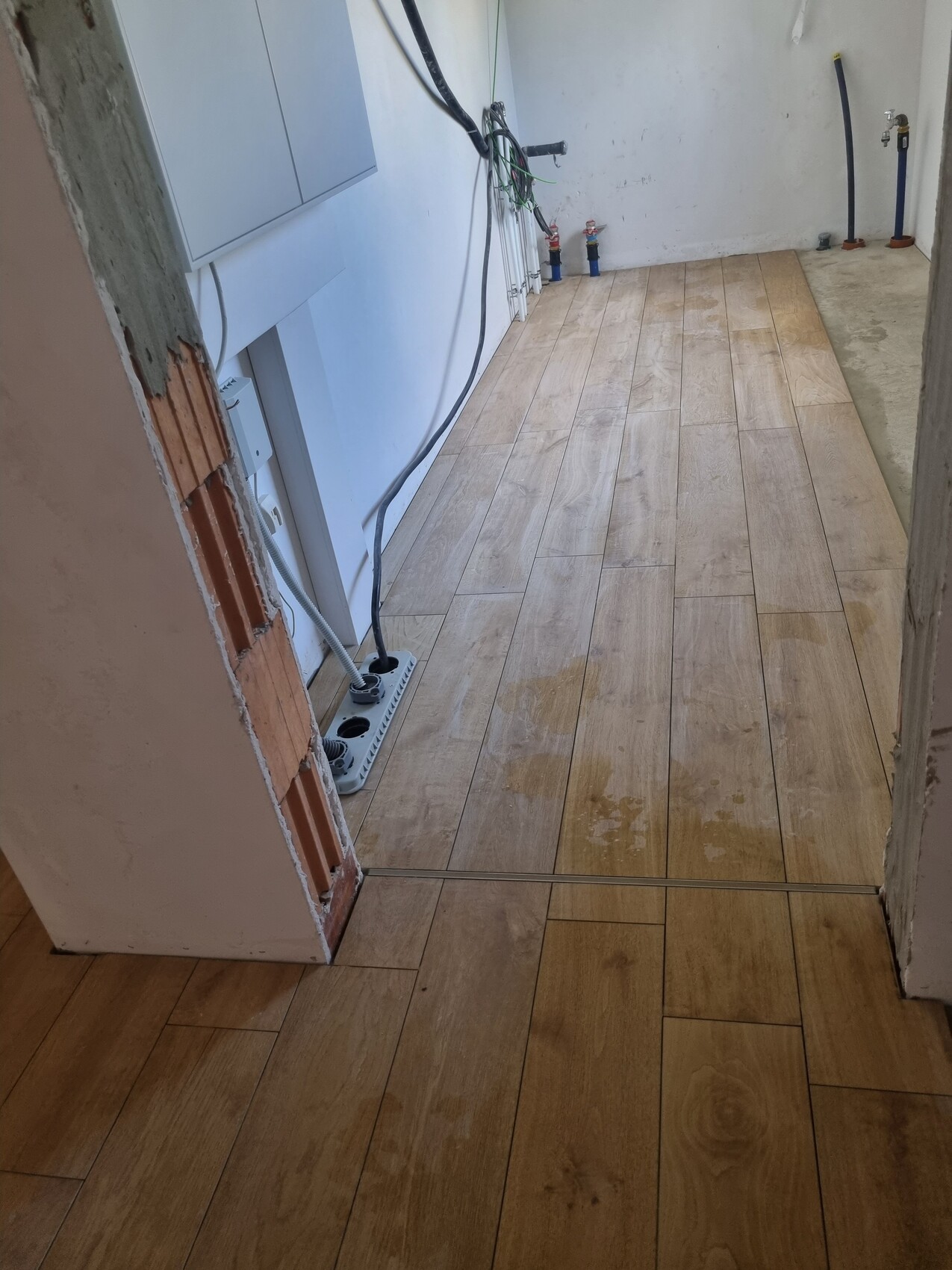

Okay. Got it. Our tiler uses rails with interchangeable rubber inserts.

Neubau2022 schrieb:
And how does it work with tiles?
Anchors are used. However, this only works if the heating circuits behave similarly, meaning the floor expansion is the same.
motorradsilke
31 Aug 2022 14:58
Neubau2022 schrieb:
And how does that work with tiles?
A silicone joint is simply placed directly over the expansion joint, exactly where your rail is.
