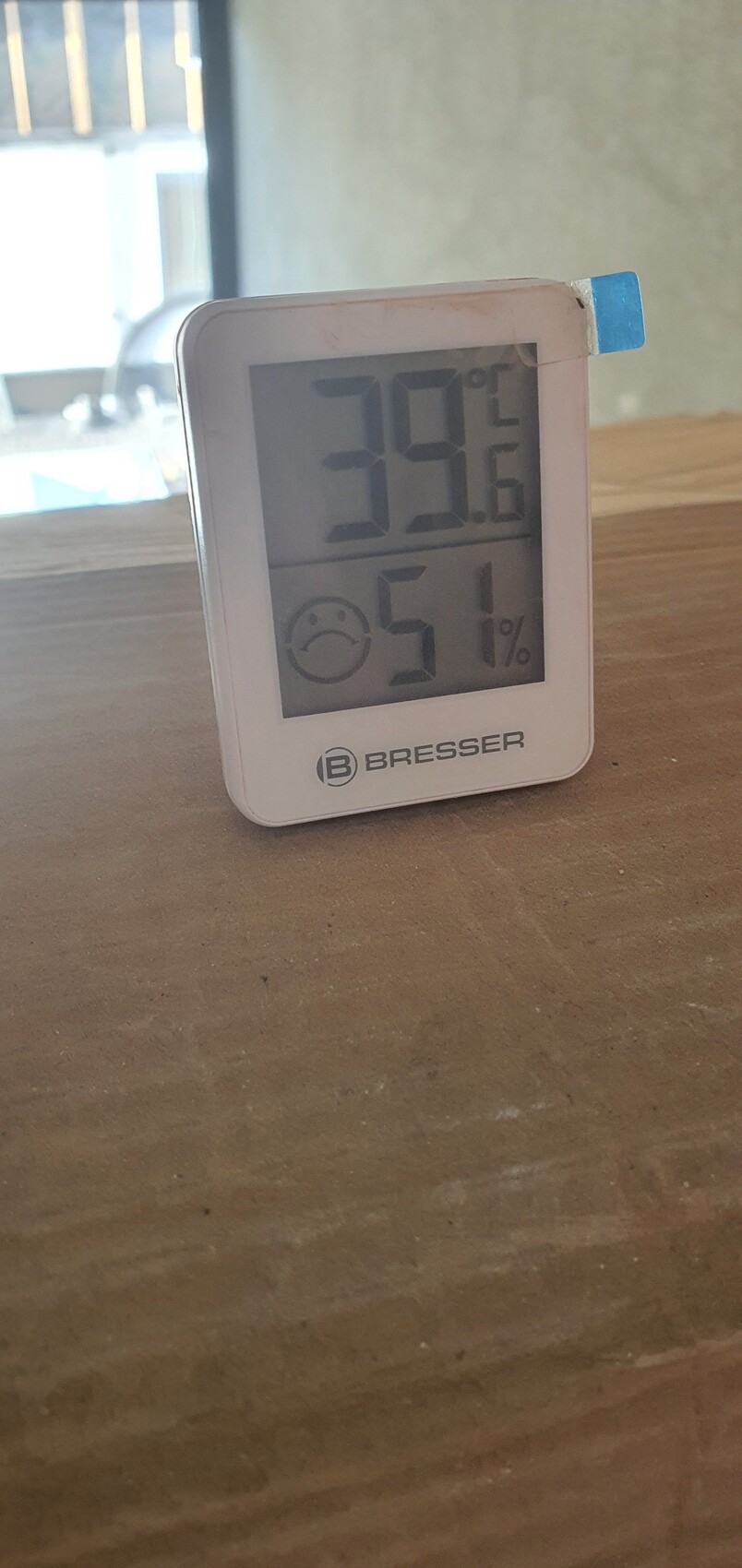

Regarding functional heating:
Yesterday, the underfloor heating reached 40°C (104°F). Room temperature 34°C (93°F)!!! Humidity before airing was 54%, after airing 58%!!! I think I can gradually skip airing 😉 . During the day, it doesn’t seem worthwhile. Today, I aired at 5 a.m. (!) and managed to lower the indoor temperature from 34.9°C (95°F) to 27°C (81°F). Unfortunately, with the current weather, airing during the day doesn’t work. Electricity consumption in the first seven days was 110 kWh, half of which was covered by the already connected photovoltaic system. The air-to-water heat pump cycles frequently and runs at a max of 2200 W (since 5 a.m. today without pause).
