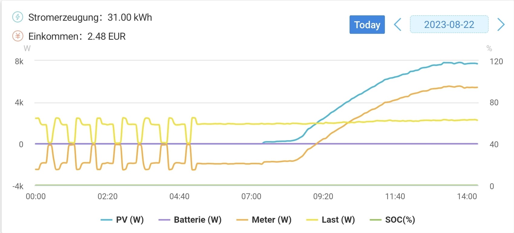

3. Short cycling of the heat pump should not occur at all. There should be a specific screed program to prevent short cycling.

3. Cycling of the heat pump. That should not happen at all. There should be a special screed heating program to prevent cycling.Thanks for your feedback. 1. Yes, I understand. The “beer-from-the-fridge principle.” I’m just wondering why there was no condensation at all, even during the cooler days at the end of July.
2. Yes, the screed contractor specified it, so it’s done that way (for warranty reasons).
3. The cycling of the pump annoys me as well. The heating installer selected a screed heating program. He also said from the start that the pump will cycle.
You can clearly see it here in the picture (app of the photovoltaic system).
