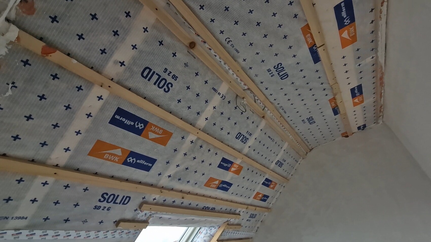

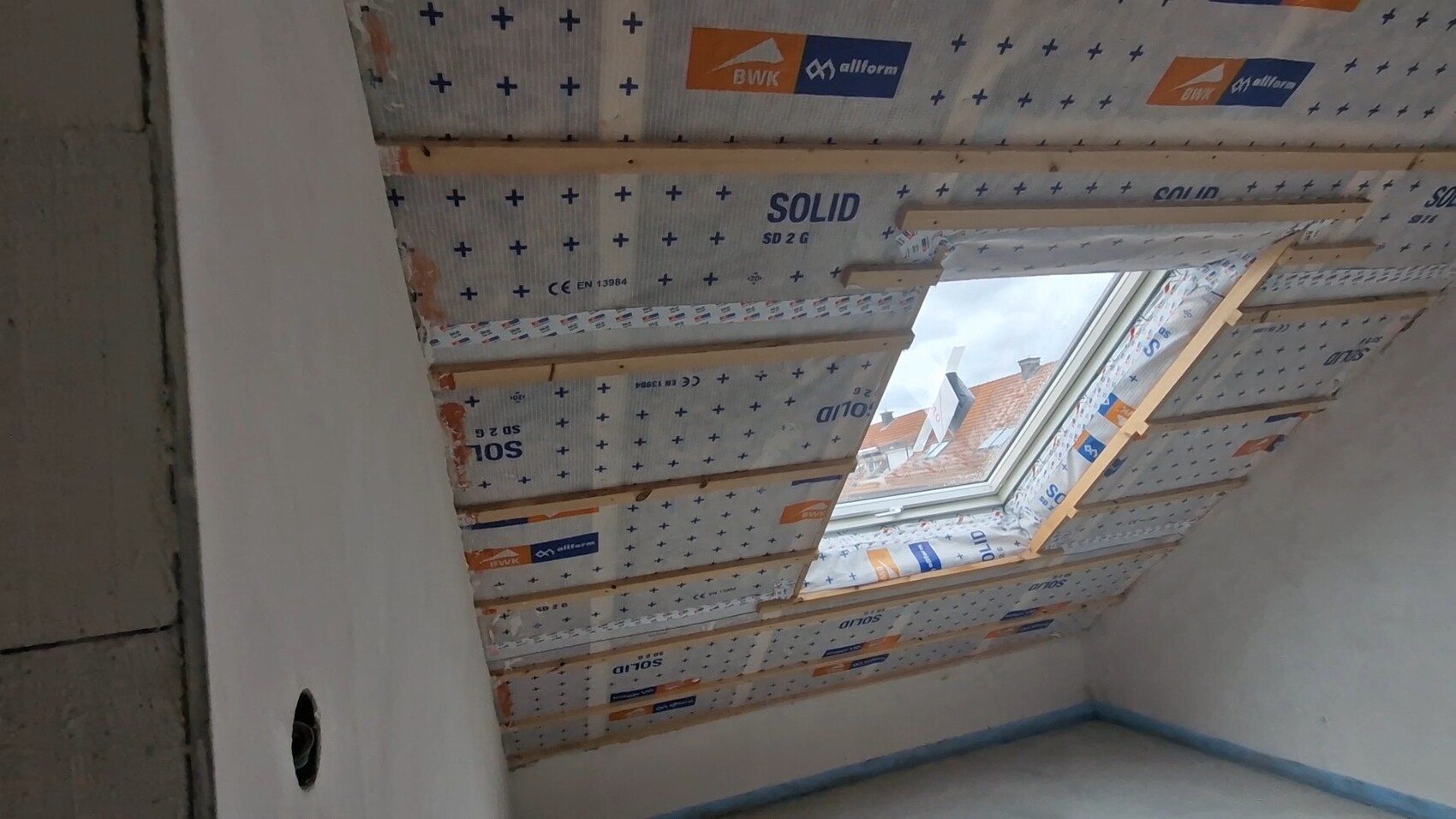

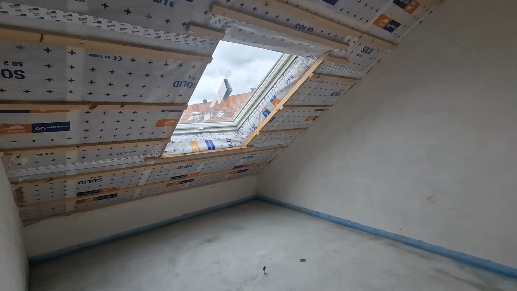

The interior plaster has been in place for 4 weeks now, and finally, the screed was installed in the house last Thursday. My neighbors, who are building with us, were airing out the house and mentioned that the attic is still very damp. Unfortunately, all the windows were closed when the screed was laid, and it’s extremely hot, so it’s currently not possible to enter. They ventilated the other two floors with shock ventilation. We will wait another day.
Now the painter wants to come next week to prime the walls and so on. However, I’m not ready for that yet. I want to ventilate thoroughly and let the screed dry properly first. I wanted to ask you if it’s really necessary to wait? We will be applying primer on the plaster and then spray paint directly afterwards.
What else should I consider regarding the screed, and when can flooring be installed on it? What work can be done in parallel once the screed can bear weight?

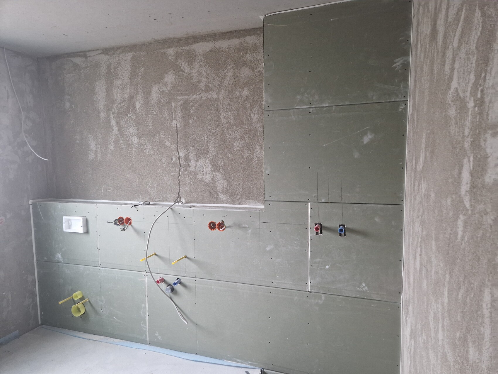

Bauherrin12326 Jul 2023 22:45sysrun80 schrieb:
Oh, you mean full, floor-to-ceiling walls. I was thinking more about partial walls in the bathroom, etc.Sorry, maybe I’m not explaining myself clearly. Here are the walls and ceiling from the attic, for example, and then in the bathroom the wall behind the toilet and the partition just to hide the drains.
Bauherrin12326 Jul 2023 22:52xMisterDx schrieb:
You shouldn’t underestimate the load that a drywall partition would transfer to the screed in the bathroom, especially if a washbasin and a vanity cabinet are mounted on it. Plus, the weight of the tiles that will be applied on top. Even the insulation under the screed has a limited load-bearing capacity. Okay, so what does that mean exactly? Is it nonsense that they are installing the walls on Wednesday, which is about two weeks after the screed, so they just have to wait? For example, with the neighbors, the bathroom wall is already finished. Honestly, I hadn’t considered the weight aspect at all.
Bauherrin123 schrieb:
Okay, so what does that mean now? Is it nonsense that they build the walls two weeks after the screed, like on Wednesday, and that they have to wait? For example, at the neighbors, the bathroom wall is already finished. Honestly, I hadn’t even thought about the weights. Stay calm ;-) You’re not installing a car lift here. Sometimes people tend to exaggerate to emphasize their points and imagine the worst-case scenario. 😉
