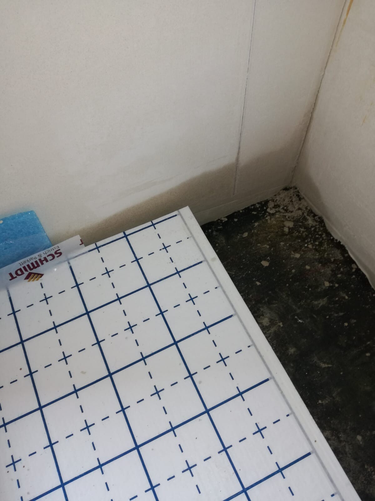

We have had the screed in the house for just under two weeks. Today, I noticed in one corner of the bathroom, where the recess for the bathtub is located, that moisture is collecting and rising up the wall. The underfloor heating is running in drying mode. Could this be caused by moisture in the screed, or is there another issue?
Ecke eines Raums mit einer weißen Bauplatte und blauem Gitternetz auf dunklem Boden.
Z
Zaba12
8 Jul 2021 20:55
I find it suspicious that moisture is rising there without screed being present. I can't recall seeing anything like that in our area.
driver55
8 Jul 2021 21:12
To me, this seems questionable.
Exactly where there is no screed, the area that is recessed, is it damp there?
The recess can’t be for a bathtub, it’s only about 40 cm (16 inches) wide.
Or how should the picture be interpreted?
