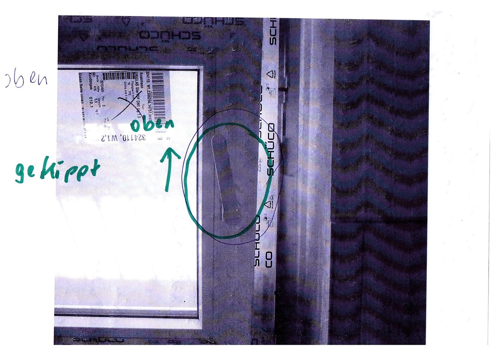

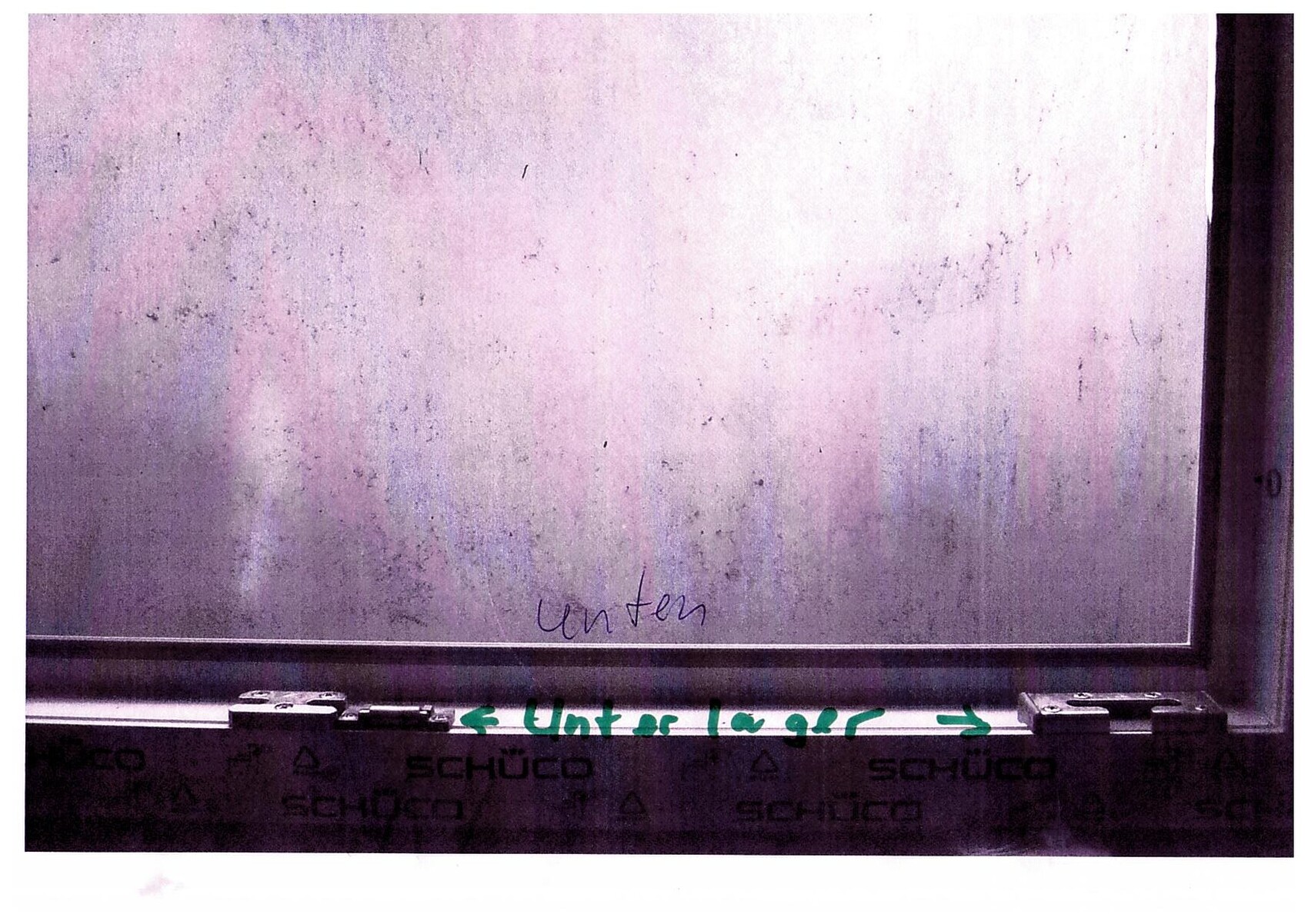

Kubasilver9 Jul 2023 19:48Hello, I have installed a new tilt-and-turn window Schüco CT-70 Profiserie Classic. I have installed about 10 windows before and never had any problems. I am a precision mechanic. Now, with the window tilted, the handle cannot be positioned fully vertical, although all functions work perfectly and the handle positions for turn and closed are correct. Even after removing the spacers, the handle cannot be rotated to the vertical position. So, it can’t be due to the mushroom cams. But what is wrong here? Can this issue be fixed or is the gear mechanism defective?

Kubasilver18 Jul 2023 18:55Proper troubleshooting! Open the window, remove the handle, take out the gearbox, set it into the correct position, and reinstall it. Put the handle back on and check all functions. This error is very rare and can only occur due to factory installation.
