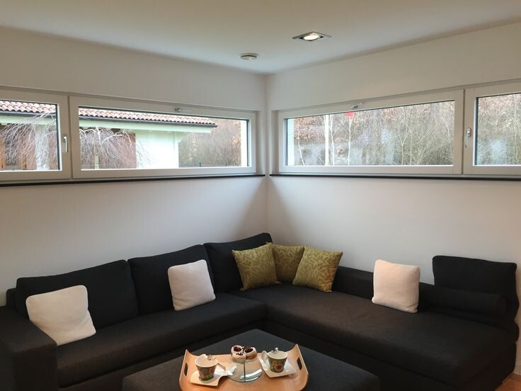

What do you think about those tall, narrow windows placed in the middle between the floor-to-ceiling windows? (attached) What are those called again?

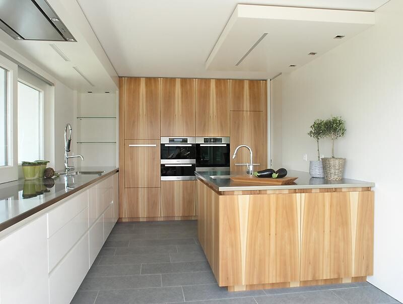

@ypg: Those are 120 x 120 centimeters (47 x 47 inches). I’m attaching a picture here as well. I copied the idea and want to steal it. Basically, nothing except the Thermomix should be there. So no chairs either. Just storage and work surface. So that two people can stand opposite each other and prep food.
