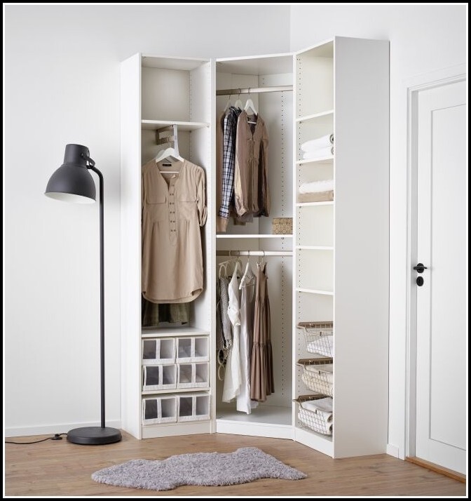

Schnuckline3 Apr 2017 01:17@11ant haha No, this is actually a specific Pax wardrobe from IKEA. The two corner wardrobes are for hanging clothes, and the section for folded clothes is 35 cm deep (14 inches). At least, that’s what IKEA says. I’ll attach a photo.

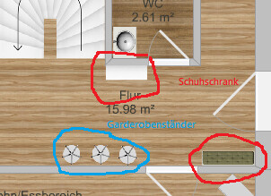

In the entrance area, I’ve planned two (shoe) cabinets and three coat racks. I’ll also add a picture. Do you think that’s not enough? I’m not experienced with having children.

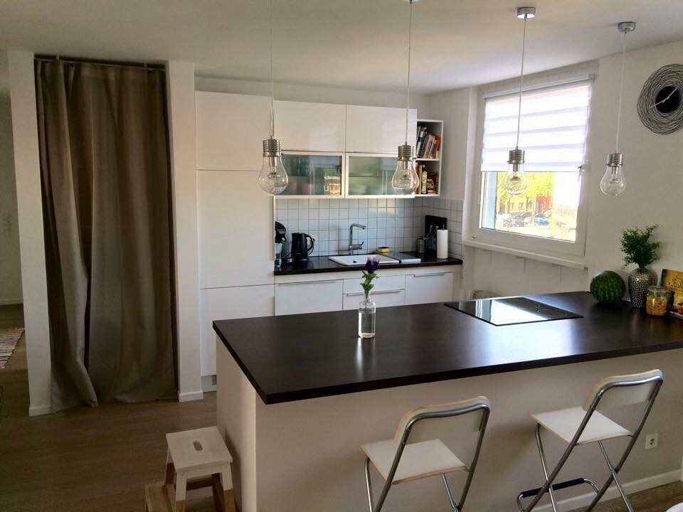

Oh, and the absence of a door in the “storage room” is also deliberate. That would take up too much space. It will be separated with a curtain like in the attached picture.
