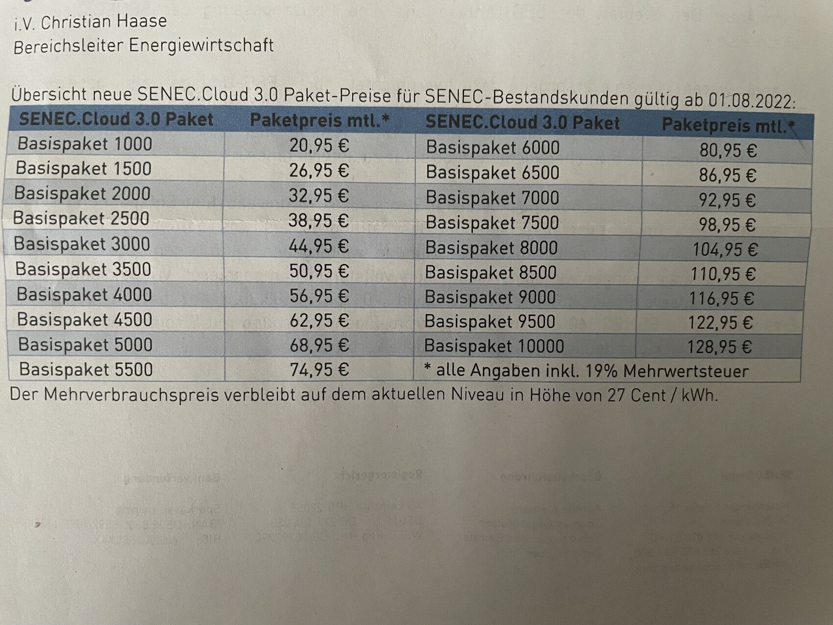

DaGoodness schrieb:
Exactly, you pay a monthly subscription fee and in return, you can draw a certain amount of electricity from the grid for free during winter that you fed into the grid during summer.
If you feed in more, the difference is reimbursed. If you consume more from the grid than you feed in, you have to pay extra for the additional consumption.
Currently, my cost for the extra consumption is 28 cents per kWh.
That’s quite reasonable, I expected a higher price. What factors influence the price?
DaGoodness
5 Aug 2022 20:55
Attached is the current price list as of August 1, 2022.
It's even only 27 cents :p
Preisübersicht SENEC.Cloud 3.0: Paketpreise für Basispakete 1000–5500 und 6000–10000.
