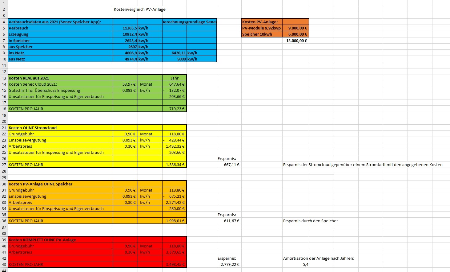

Since May 2020, I have had a 10 kWp (kilowatt peak) system on my roof and a 10 kWh (kilowatt-hour) battery storage in the utility room. Additionally, since August 2020, I have been using an energy cloud service provided by the company Senec (EnBW).
With this service, the electricity fed into the grid during summer is credited to an account and can be drawn again in winter at favorable conditions. The general opinion on this topic everywhere is that it is not worthwhile. The same applies to the question of whether to have storage or not.
Therefore, I made a cost breakdown for myself and compared my current expenses with different scenarios such as "energy cloud service or regular electricity tariff," "photovoltaic system with and without storage," and the costs "completely without a photovoltaic system."
Attached you will find my breakdown.
Looking forward to an active discussion.

DaGoodness4 Aug 2022 13:30driver55 schrieb:
I can’t follow the explanations, and whenever I see kW/h, I stop reading anyway… Please excuse the incorrect term. Just ignore the slash 🙄
I’ll try to simplify it.
Thanks to the photovoltaic system, battery storage, and electricity cloud service, my total costs last year were 719.23 euros.
Without the electricity cloud service and using a standard electricity tariff with a 9.90€ (approximately $10.50) monthly basic fee and a consumption rate of 30 cents per kWh (kilowatt-hour), I would have paid 1,386.34 euros, which is 667.11 euros more. So in this case, the electricity cloud is cheaper.
Without the battery storage, I would have fed more electricity back into the grid and also had to draw more from it. This would have resulted in additional costs of 611.67 euros.
If I had no photovoltaic system at all, assuming again the electricity price of a 9.90€ (approximately $10.50) basic monthly fee and 30 cents per kWh, I would have paid 3,498.45 euros in total. That equals a savings of 2,779.22 euros in one year.
With an investment of 15,000 euros, the system would have paid for itself in 5.4 years.
I didn’t actually find any contradictions in the screenshot. It seems to make sense to you now. How secure is the basic fee for the coming years? Is that contractually fixed?
