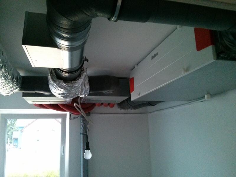

Yes. A Helios controlled residential ventilation system 340 D is installed. Any experience? I like my controlled residential ventilation. Since it’s the first one and I don’t know anyone else who has one, I naturally have no comparison.
However, I feel that it does what it’s supposed to and that the indoor climate is better than it was in the apartment before. We were recently on vacation for a week and were surprised at how fresh the air in the house was when we returned.
Space-wise, I find ceiling mounting great! I would never have used that space anyway.
