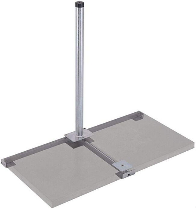

I am currently building a new house and wanted to ask whether I should go with the standard star wiring or the Unicable system. There are a total of 8 outlets, but only up to 4 will be used at the same time. Only one satellite is to be received.
Due to the limited space available on the roof, only this type of model can be used.
An even better option would be one with the pole at the narrow end. However, I have only ever found those with a single panel.
That way, even with the evening sun from the west, the dish would never cast a shadow, as it could be placed right at the edge.
