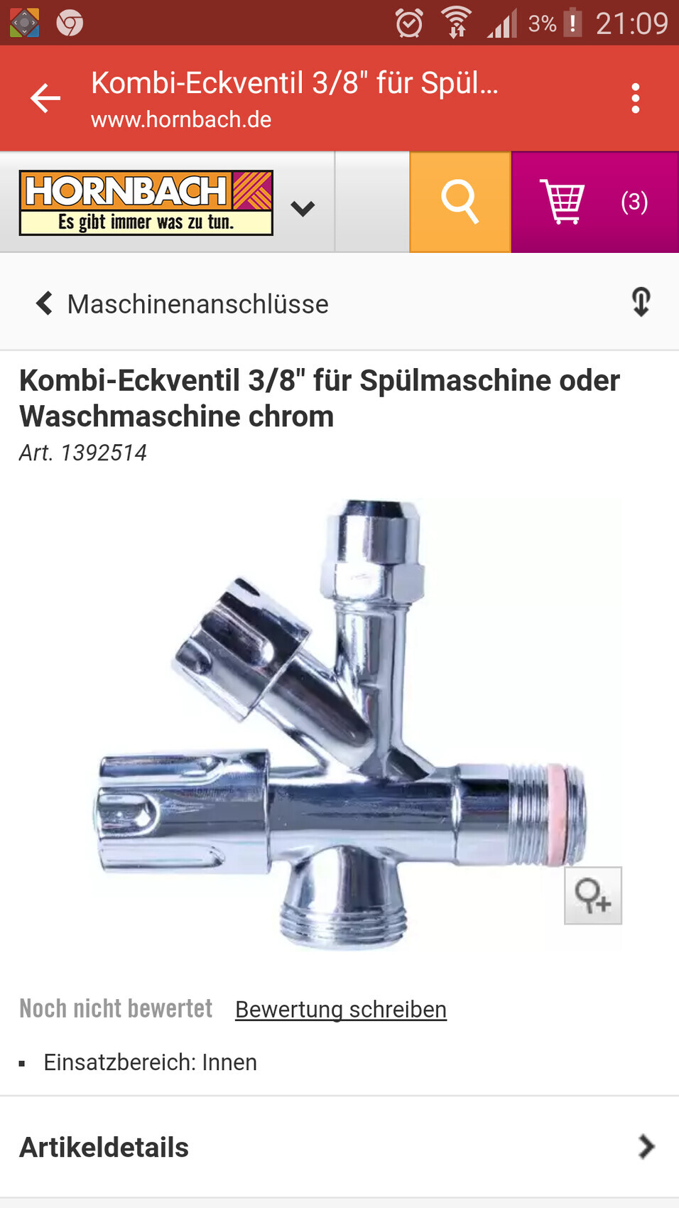

tomtom792 Jun 2017 21:19
This is the right one! It is screwed directly into the wall above the fresh water supply for the faucet and the dishwasher.
Chrome combination angle valve 3/8 inch for dishwasher or washing machine

Okay, then I need a 90-degree angle because the connection in my case points straight upwards.

wrobel5 Jun 2017 15:10
Hello
WAS Eckfix is your solution.
