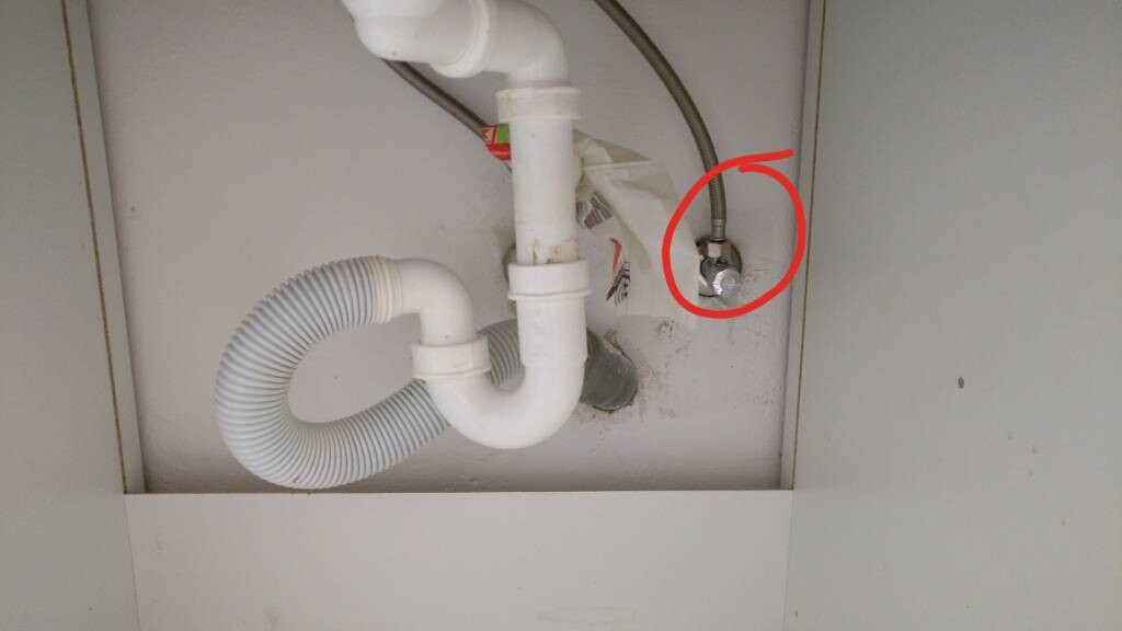

Hello and good evening,
I’m trying to quickly find out which adapter I need or what it is exactly called.
It is supposed to be a fresh water supply for a dishwasher.
There has to be an adapter or a flexible connector to the regular kitchen sink water supply.
I think the kitchen sink supply is 1/4 inch, a standard flexible metal-braided supply line. The dishwasher connection is 3/4 inch, I believe. What fits here?

Drain pipe, trap, and pipe connections visible under the washbasin
