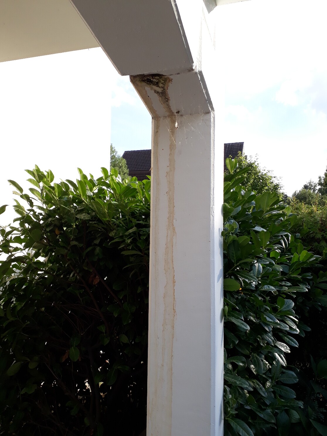

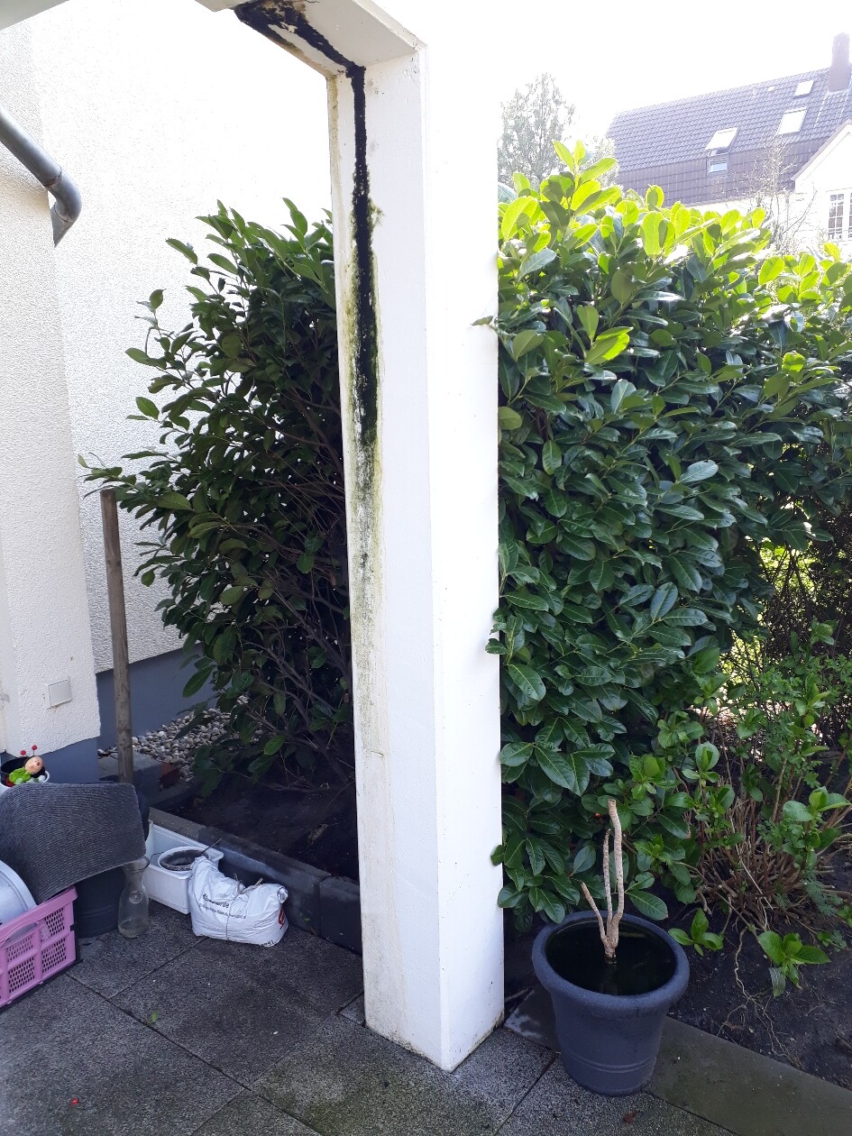

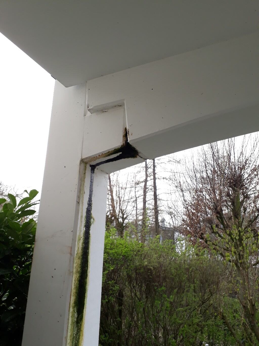

We live on the ground floor of a multi-family building and have a terrace. Above the terrace are the balconies of the residents living above us, all connected by columns and the exterior wall. Since we moved in (in 2018, but the previous tenants probably already had this problem), one of the columns has been leaking greenish, rust-colored water; it drips out or flows slightly when it rains, see pictures.
Has anyone experienced something similar and can tell me how serious this might be? I’m not an expert, but I think the steel inside the masonry or the pillar is rusting, and at some point, this could compromise the structural integrity of the entire construction.
What are your thoughts, and which type of professional (structural engineer, building surveyor, mason) would be best to inspect this issue?
Thanks in advance for your help

From the pictures, I can’t even clearly distinguish what is concrete and what is steel, where connections might intentionally not be flush or right-angled, and so on—let alone what is solid and what is hollow. Having knowledge of the construction is crucial for any diagnosis. Without plans, deviations from the intended design cannot be determined.
