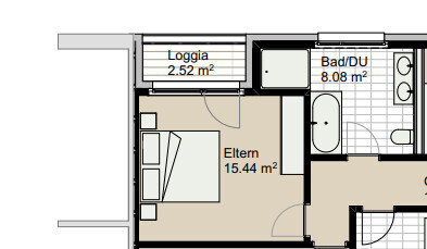

We live in a multi-family building on the 2nd floor. The building was completed last year – 2020.
Next to our bedroom is the bathroom with a shower, bathtub, sinks, and toilet.
(see picture)
Floor plan of a residential building with master bedroom, bathroom, and loggia
We have the following problem:
When our neighbors – downstairs – 1st floor – use the “rain shower head,” we hear a strong rushing noise from their rainfall shower all the way up to our apartment on the 2nd floor. This is very noticeable both in our bedroom and bathroom. When they turn the water off, we hear loud banging noises several times afterward. If they flush the toilet at a later time (several hours later), we can also hear the flushing all the way up to us. The next morning, when there is any water usage, we experience a humming/vibration in our bedroom followed by banging noises. The heating system is powered by a heat pump. Does anyone possibly have an idea what the problem could be?

That sounds very noisy. Unfortunately, this is more common than exceptional in modern houses, especially with brick construction. I am familiar with a few issues from our single-family home as well, for example, the one with the shower.
Most likely, the rain shower was installed during the shell construction phase without any decoupling from the bricks. Now the noise transfers through the structure, and you can hear it on every floor and quite loudly in the neighboring rooms.
Are the exterior walls made of hollow bricks? That would normally not be allowed in a multi-family building, but nowadays you see it quite often. These bricks do not provide protection against structure-borne sound. If someone is watching TV on the ground floor, you can hear it upstairs through the exterior wall as well.
It’s very annoying, but this is due to the construction method and not a defect. Hollow bricks act like resonating bodies.

First of all, thank you very much for your reply. Only we hear the rain shower noise... from the 1st floor to the 2nd floor. The 3rd floor, as well as the ground floor apartment, do not hear the water flow sound.
Could the problem also be related to water pressure, where it drops or is too low at the rain shower? 😕 Or could the issue be with the rain shower itself? The rain shower also has a handheld showerhead. When using the handheld shower, we hardly hear anything...
Regarding the TV... Yes, we have the same problem... We can hear someone watching TV throughout the entire house. I don’t know if they mounted the TV directly on the brick wall, and that’s why we all hear the TV through the walls... 😕
The neighbor above us also has a rain shower, but we absolutely do not hear theirs...
