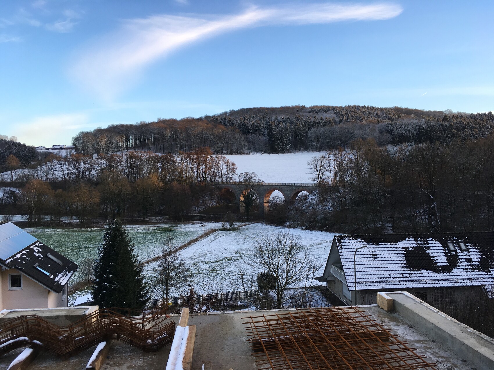

I respond to suggestions to reconsider with a view. The avatar photo shows part of what can be seen from the terrace. Another snapshot is shown below.

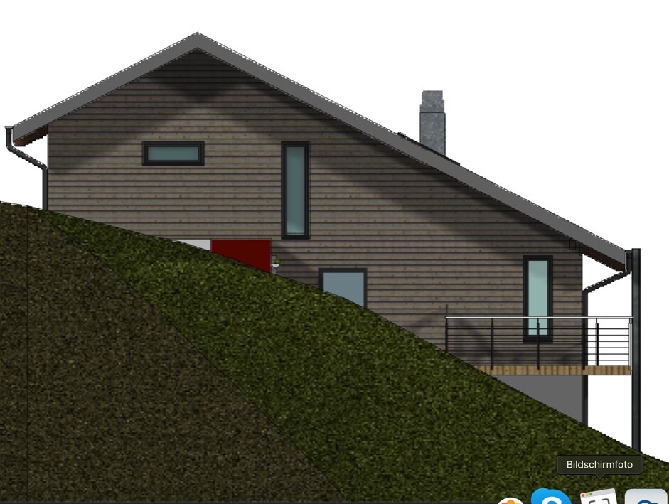

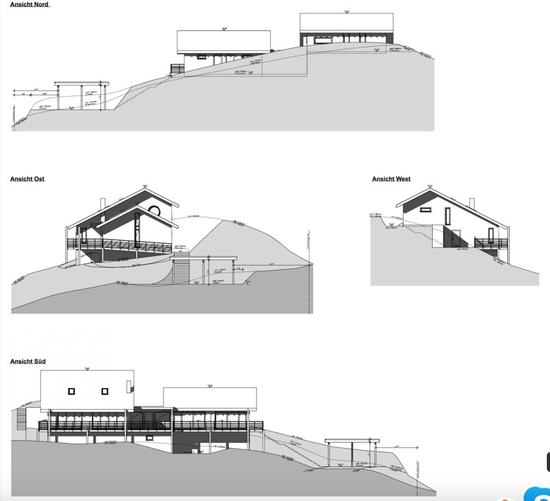

Here are some pictures of the project on a sloping site. We have the steepest slope on the west side, facing south. The terrain also slopes towards the east, so the west part of the house is built into the hillside, while the east part stands on or above the slope.
Correct on this sketch: the slope at the house. Incorrect is that the terrain rises further to the north and that we extended the driveway shown where the carport is located. Looking at the south view: on the left and in the center is the main house (about 115 m² (1237 sq ft)); on the right are two apartments (each about 35 m² (377 sq ft)) with their own entrance for the boys (almost 18 / 20 when they move in during summer). The utility room is located centrally below the terrace and has basement-like characteristics.
Below is the west side. What is shown in red here is the boulder wall we constructed. Everything behind it under the house is not living space but rock (graywacke). The exit from the kitchen is partially obscured here—it leads to an approximately 3 m (10 feet) wide area in front of this door and provides access to the garden and the terrace that runs around the house. The house can be exited at ground level again towards the north.
