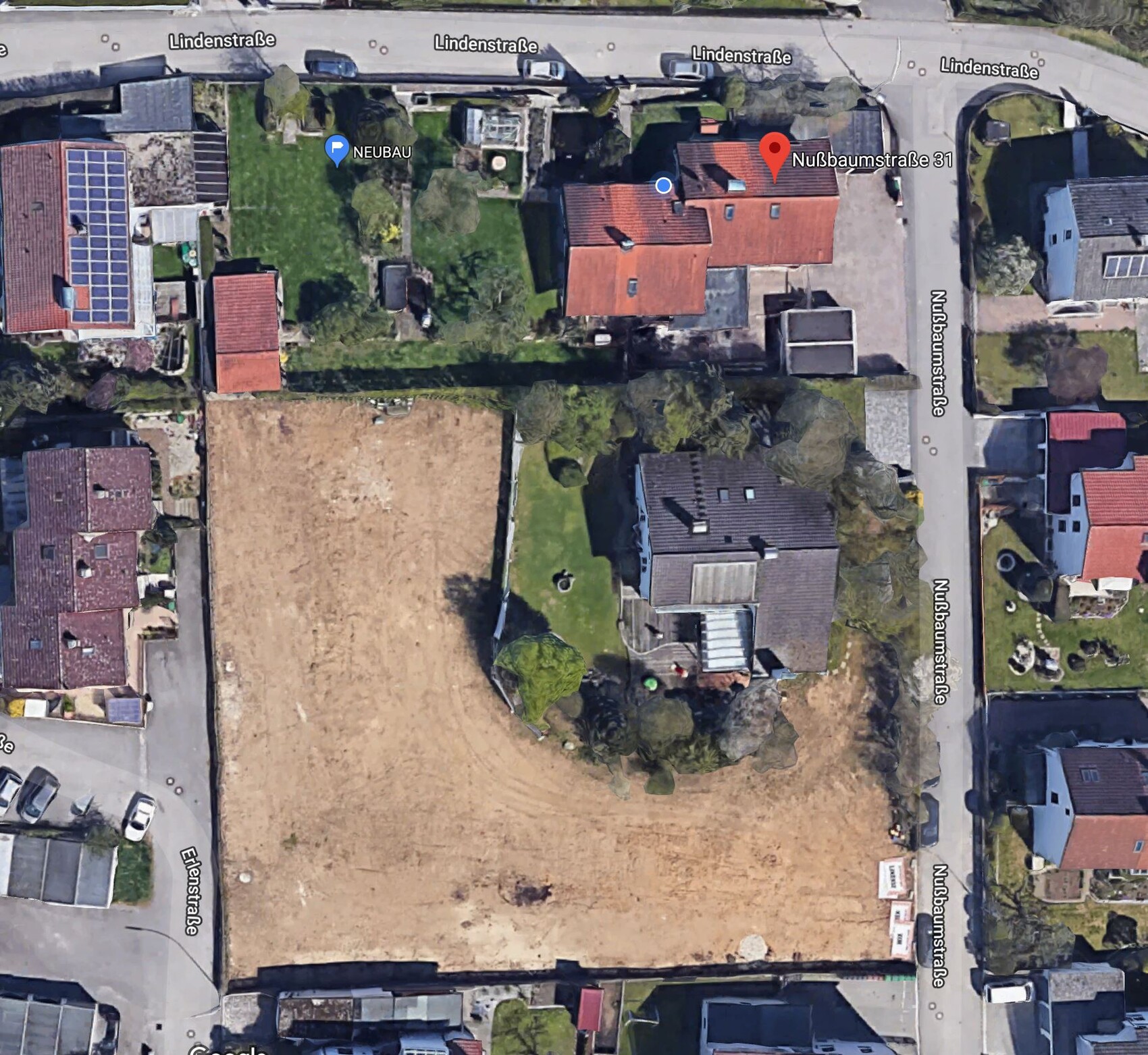

You should definitely create a scaled drawing of your plot (obtain a cadastral map and enlarge it, or use the BayernAtlas) and accurately transfer the building boundaries. It seems to me that your house might not fit within the designated building envelope, which could make all your efforts pointless. Also note that the house must maintain at least a 3m (10 feet) setback from the property boundary.This has already been confirmed by the local authority. We have such a housing shortage that almost everything is being approved nowadays. II+D is not an issue since the three new buildings on the neighboring plot are constructed in a similar way. What do you mean by saying it doesn’t fit into the building envelope? Too large for the plot?
I already mentioned above that the actual plot is larger but will be subdivided. I am attaching a photo from the BayernAtlas.
Three blocks of three-story terraced houses are being built on the neighbor’s property.

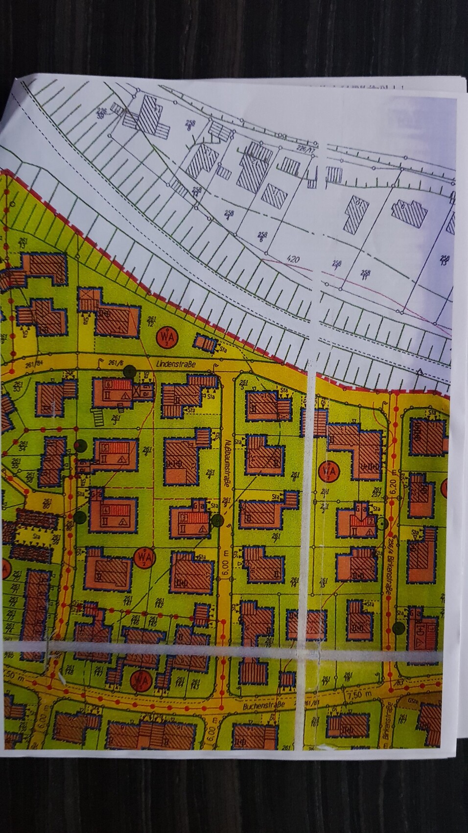

I’m attaching the development plan here. Unfortunately, the image part is only shown as a very small section. Please add the entire plan as well.
Sebastian_LA schrieb:
These new buildings do not correspond to the development plan at all. What makes you say that?
Sebastian_LA13 May 2018 21:09You need to use your 636 as a reference for the floor area ratio and plot ratio.
Regarding the aerial photo and the planned row houses: you can clearly see older row houses in the aerial image. There are also areas in this residential neighborhood that allow row houses with 2 full stories plus an attic.
However, this shouldn't be your concern now. You have your own project, and the zoning plan must be followed 🙂
Here is the entire pageYou have WA 2... which sub-item is that in picture 6?
Sebastian_LA13 May 2018 21:38ypg schrieb:
You have WA 2... which subpoint is that in picture 6?That would be 1.1.2 or 2.1.2
