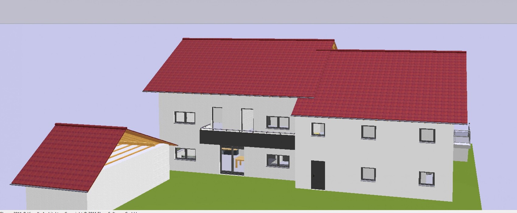

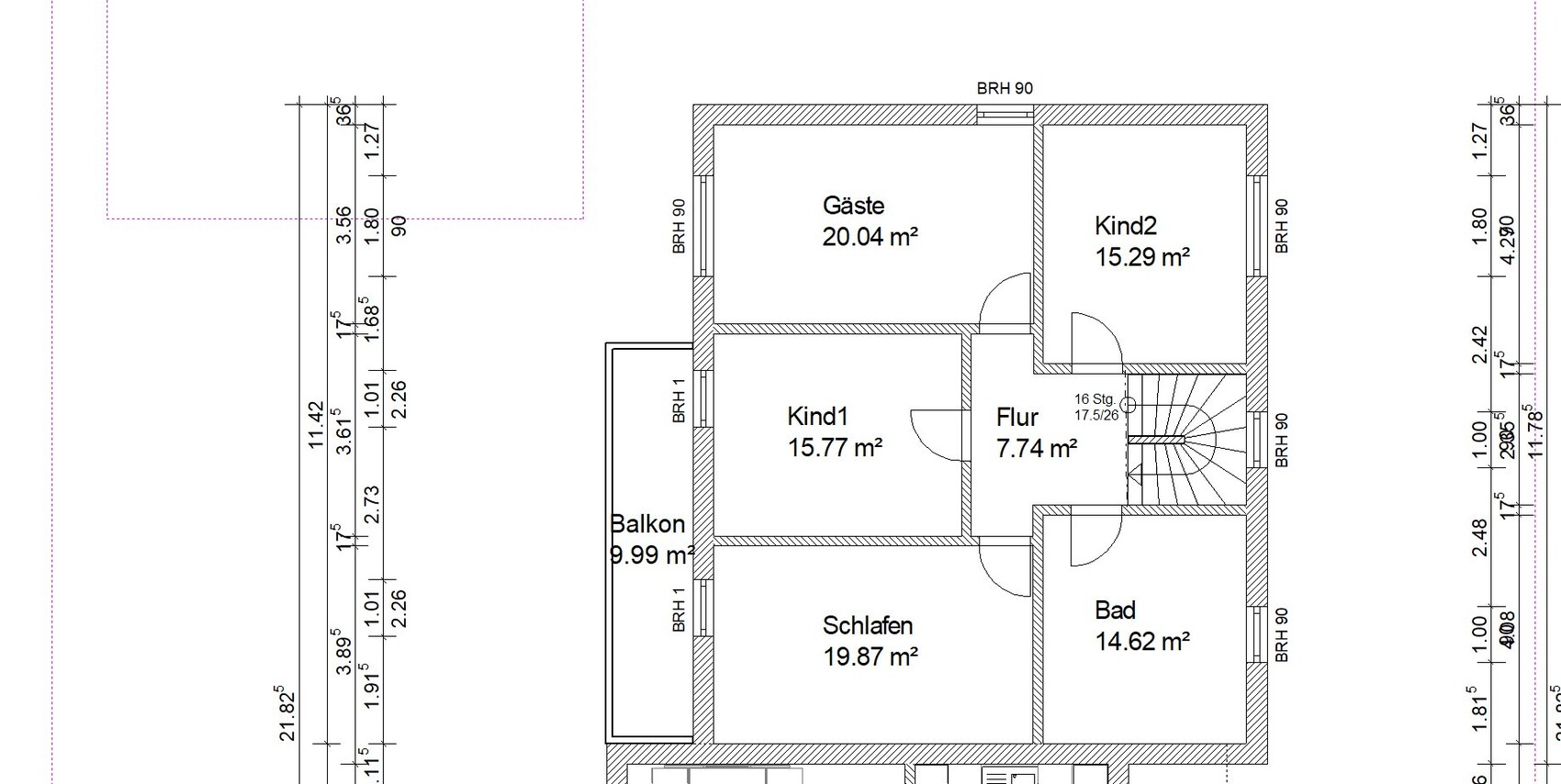

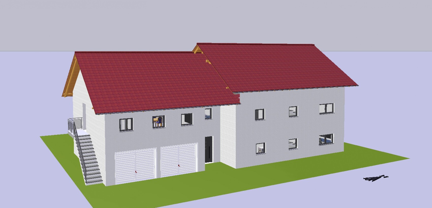

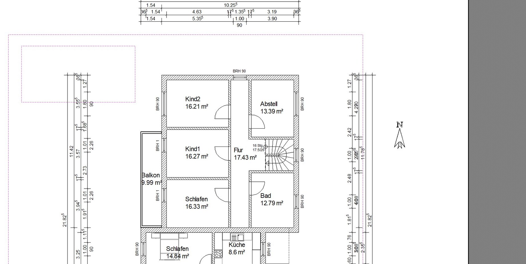

Hello dear forum community,
I am probably still at a very early stage of my project. Well, at least the building plot is already secured.
At the moment, I am trying to design a floor plan that I could be happy with.
The house is planned as a single-family home including a double garage and an upstairs granny flat.
Optionally, it should be possible to convert the single-family home into two separate apartments without major structural changes, in case we decide to rent it out.
I would simply ask you to take a look and give me all the feedback you have—anything you don’t like or that I could improve.
Usually, you only build once in your life, so it should definitely be right.
I am grateful for every reaction from you.
Sebastian

Sebastian_LA13 May 2018 11:35Have you ever thought about how dark it is right outside your front door? I also think your windows are too small. The 18m² (194ft²) children's room has, at most, a 1m (3.3ft) wide window, right? It must be dark in there all day. Having a door to the kitchen and right next to it a door to the living room seems somewhat pointless; one door or a double door would be enough.

Sebastian_LA13 May 2018 12:34Hello Curly,
Thank you for your post. Yes, the windows and doors are not yet ideal. I kept moving them back and forth during the planning phase because my main focus was on the layout of the living space.
Of course, I will correct this in due course.
