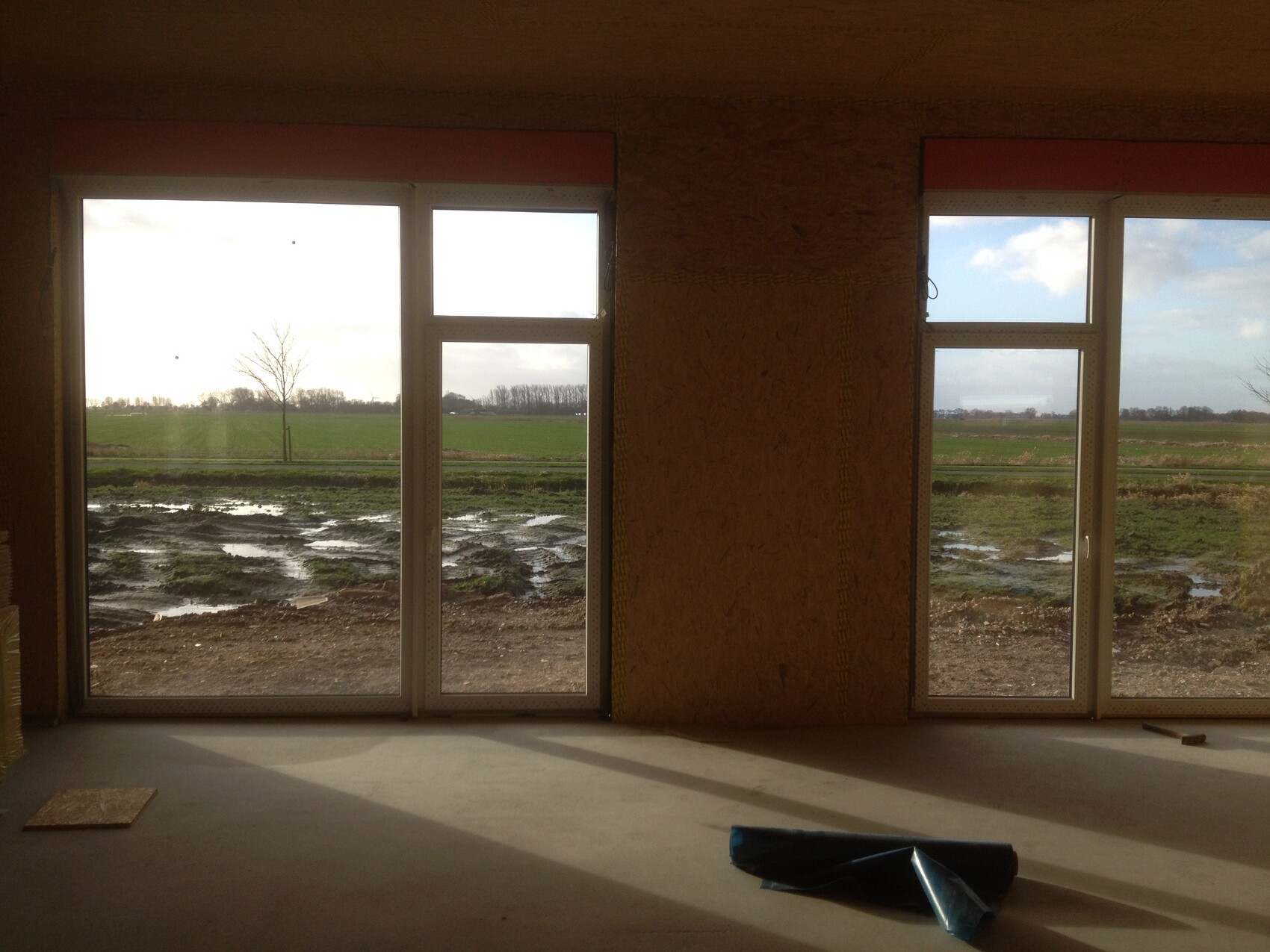

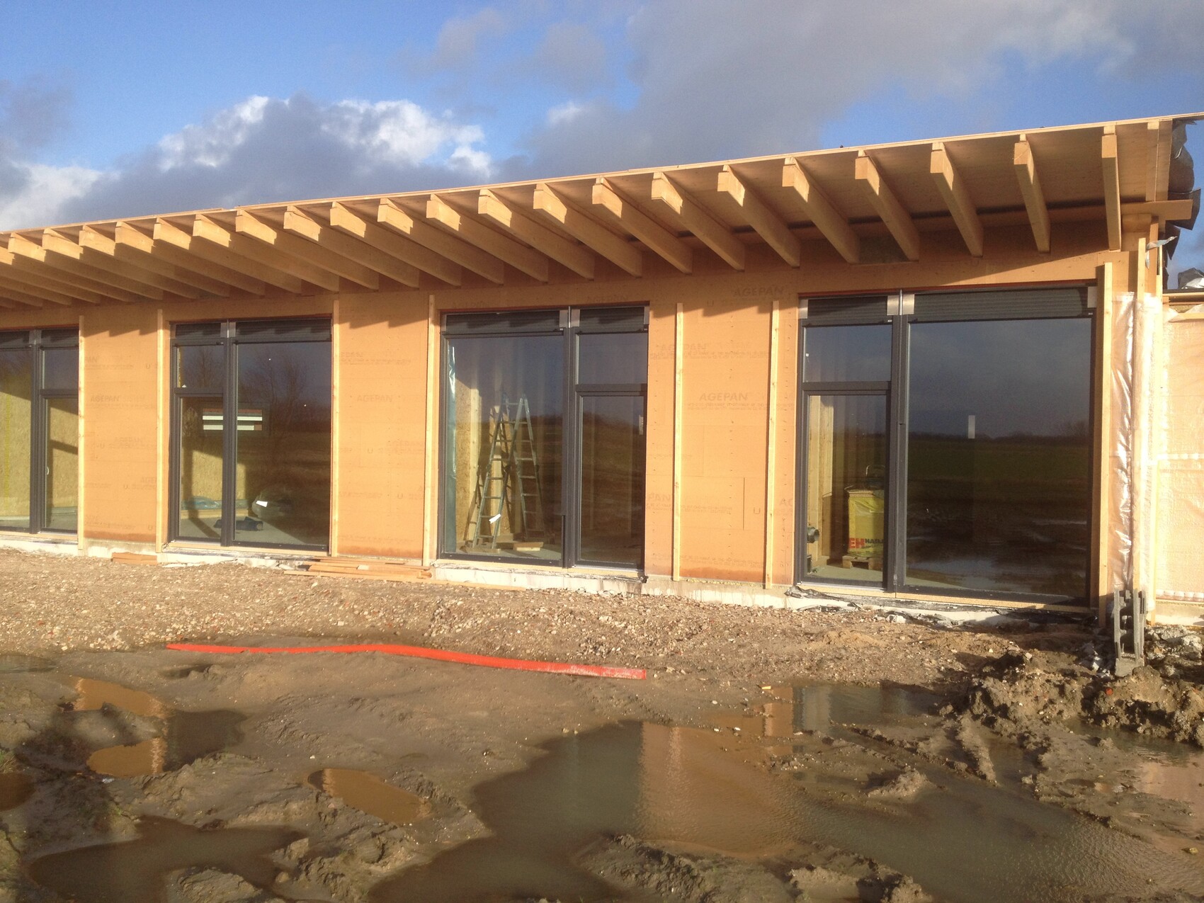

Bauherr am L18 Jun 2019 14:52wrobel schrieb:
I would choose a fixed panel covering the full height and a door with a fixed panel above it.
And the door should have a low-profile threshold. Thanks also for the pictures. That is exactly the idea of our planner. However, I wanted to ask about other options, especially non-tilt casement windows. But these seem to be quite rare.
