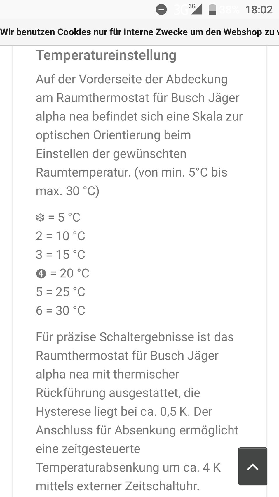

I built a new house this year and installed a Vaillant Arotherm air source heat pump with Unitower, 11 kW. The entire house has underfloor heating, and each room is equipped with a Busch Jäger room thermostat with a rotary knob. My question is how exactly should the room thermostats be set, and how does the setting on the rotary knob relate to the temperature set on the Unitower?

Ok. But did I understand correctly? If I set it to 6, I should roughly reach the set temperature of the unit heater?
Mycraft13 Nov 2018 17:49
Set to 6 = always on.
Whether and what temperatures are reached depends on how well your underfloor heating system was designed and installed.
Nafets444
13 Nov 2018 18:04
I thought the thermostats would close the valve at the corresponding room temperature for the different settings, as shown in the uploaded picture...
Screenshot einer Temperatureinstellungsseite mit Raumthermostat-Text und Temperaturoptionen
