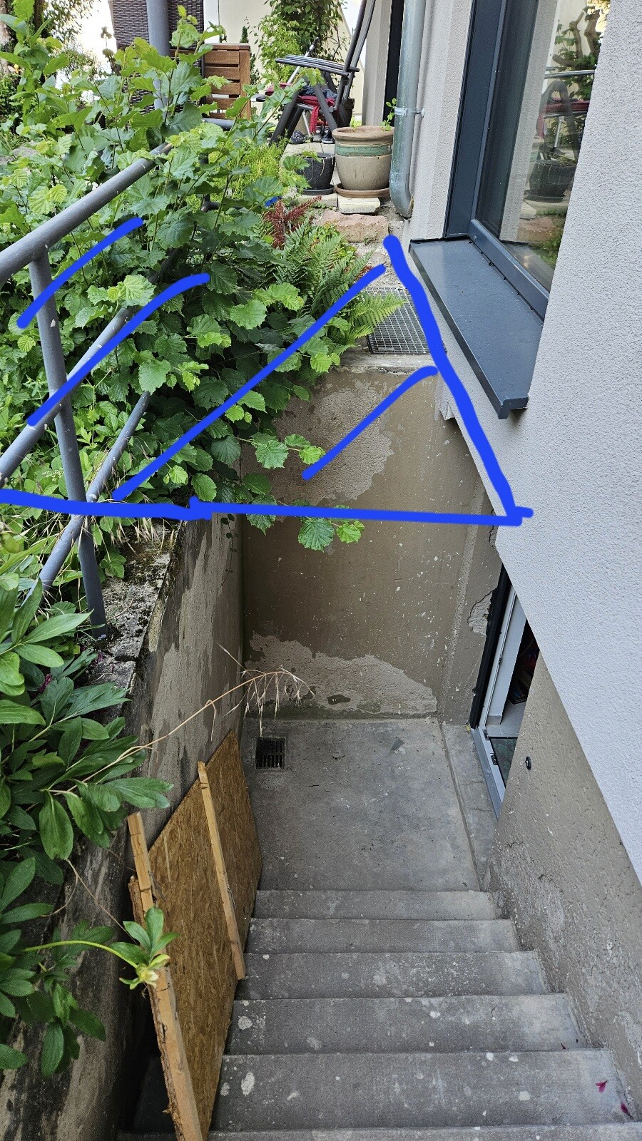

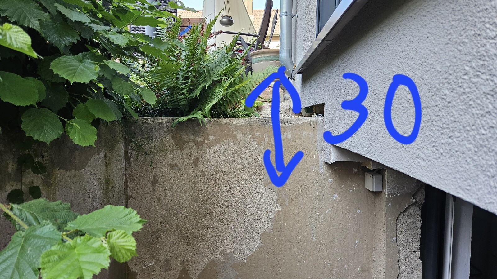

I would like to expand my terrace, which would require covering part of the basement stairway.
With the terrace extension, there would also be a height difference of about 30cm (12 inches) to level out, so the covering needs to be load-bearing.
Do you have any ideas on how this could be achieved?
I was thinking maybe using formwork from below and then pouring a concrete slab in 2-3 stages?
And somehow working with lintels and steel beams? I find the attachment to the house challenging due to the 18cm (7-inch) external thermal insulation system (ETICS).
What is the best way to do something like this?
I tried to illustrate it in 3 pictures
