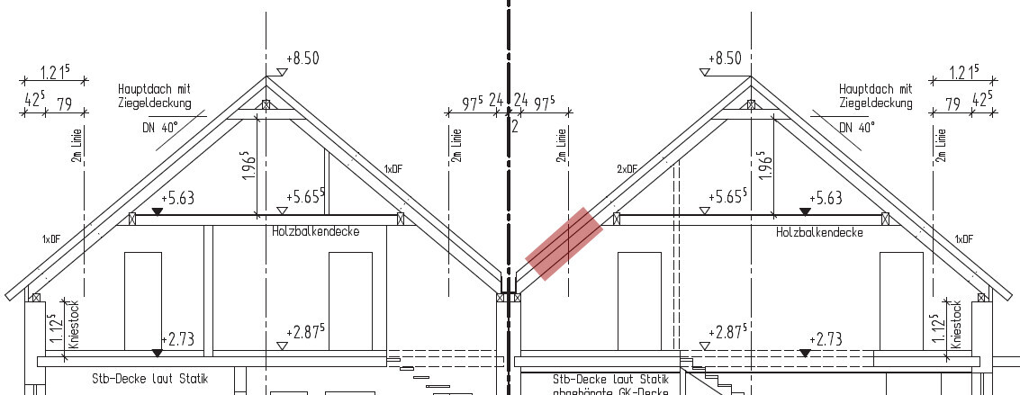

I would like to install a roof window in my upper floor. Unfortunately, I don’t have enough space because it’s a semi-detached house, and here (in Bavaria) I need to maintain a 1.25m (4 ft) distance between the neighbor’s property and the roof window. If I move it in that far, the ceiling would already reach the attic floor.
So, I thought about mimicking this with an LED panel and a self-built window frame. It would be frosted or diffused, but my main goal is the lighting effect and atmosphere. Besides the very strong and large LED panel, it would also need a control system with a sensor that measures the current outdoor lighting conditions to replicate them.
This is probably very expensive or even not feasible—but I thought I’d share the idea here. Maybe someone has some suggestions. I just don’t want it to end up looking like a panel simply screwed to the ceiling.

Fuchsbau3530 May 2022 07:11nullhorn schrieb:
I would like to install a window in the area marked in red, but according to the Bavarian Building Code (BayBO), that is not allowed—unless it is a fire-rated window.
What is the downside of a fire-rated window? If I understand correctly, they usually have fixed glazing. If it is only for light, that could be an option.
Fuchsbau35 schrieb:
What is the disadvantage of a fire protection window? If I understand correctly, these usually have fixed glazing. If it’s only about letting in light, that could be an option.Nothing, and among the options mentioned above, it will probably be the most cost-effective. I just have to submit the drawings again, but that’s fine. I also searched for fire-rated roof windows once, but they are not that easy to find.
