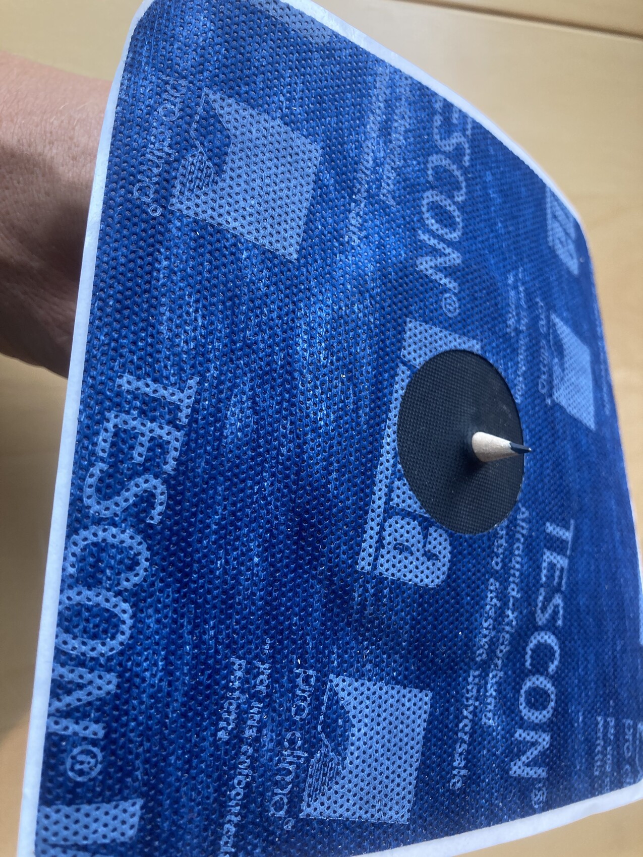

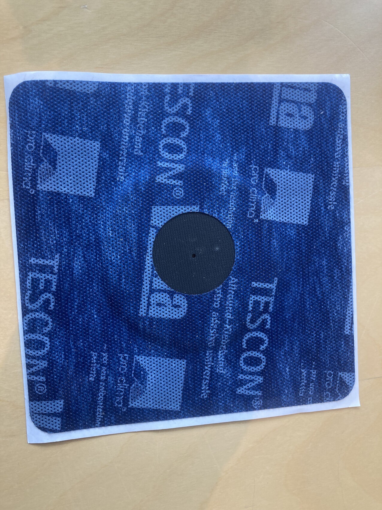

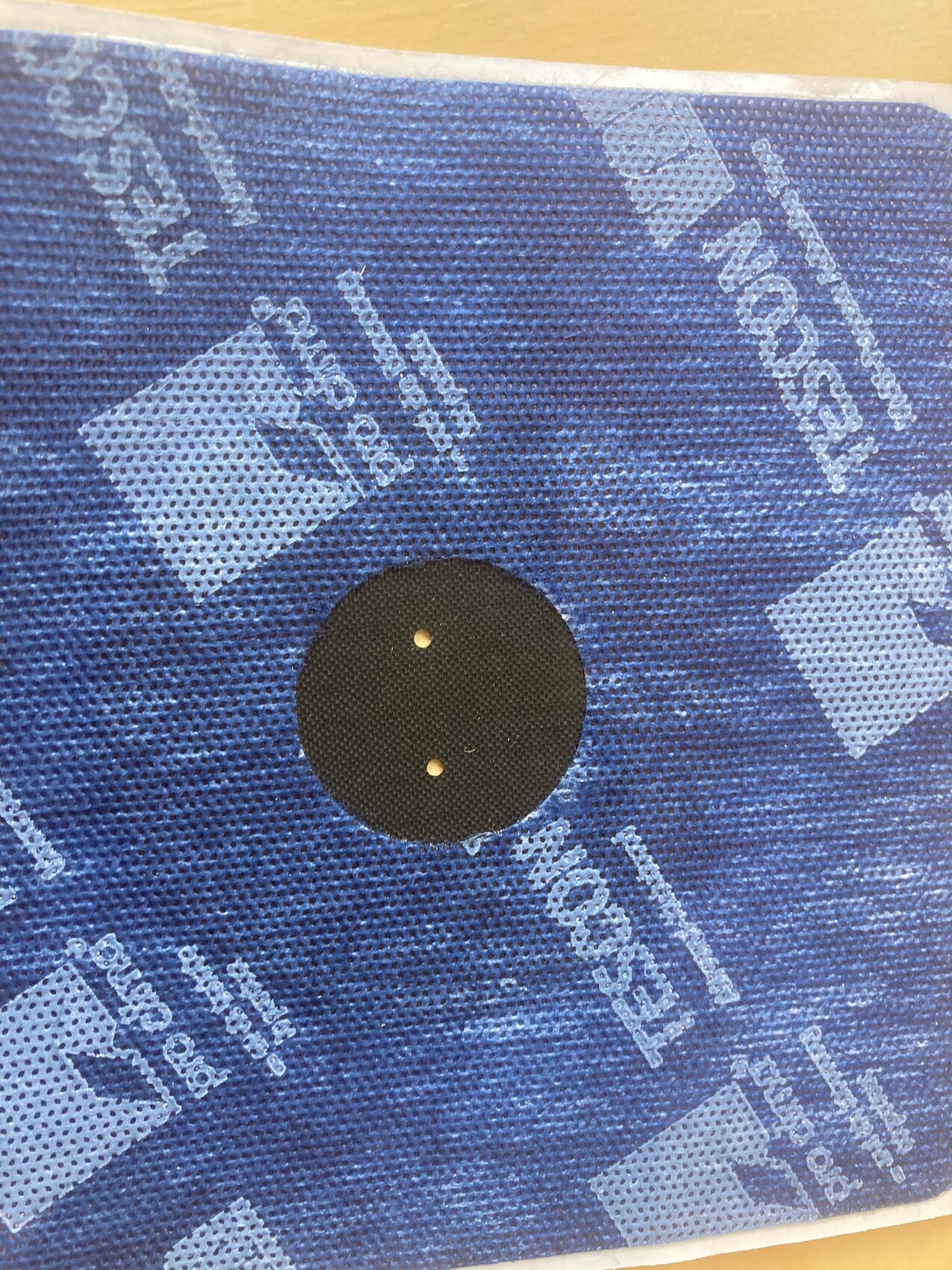

borderpuschl8 Sep 2022 10:30The cable for this should be placed within your insulation between the rafters. You just need to pass it through the membrane—or hopefully not a foil layer. There are special membrane sleeves for this, such as KAFLEX. From there, it goes through the battens into the electrical box installed by your electrician. I’ll look for a picture to illustrate this.

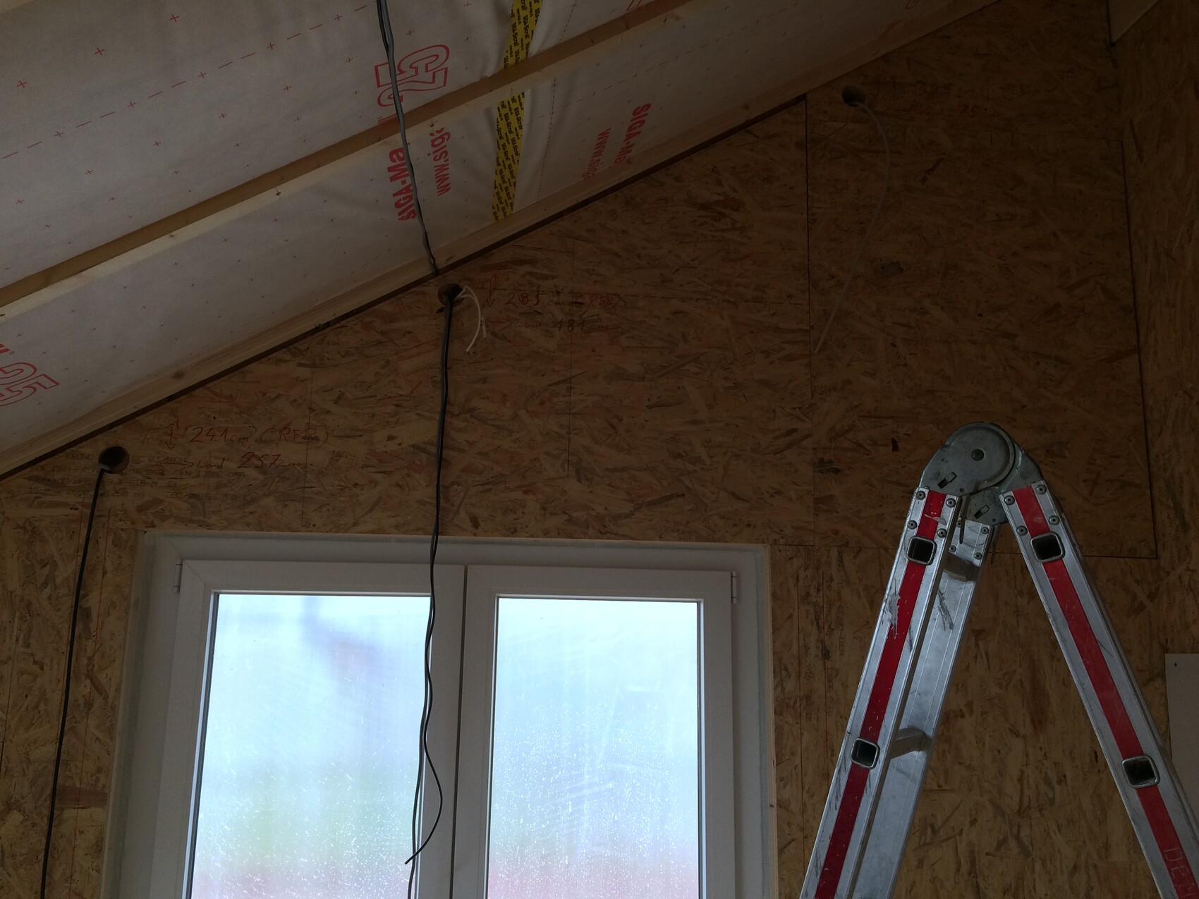

borderpuschl8 Sep 2022 10:42In the picture, the cables are routed through the wall.
Is it also possible to do this on the sloped ceiling?
Do you know on which side the Roto roller shutters need to be connected? In other words, on which side the junction box should be installed?

borderpuschl8 Sep 2022 10:59The junction box is already inside the wall. You just need to run the cable from the roof window through the membrane, for which there are special adhesives, and then along the sloped ceiling into the junction box on the side inside the wall. Your roof window will be wired there.
