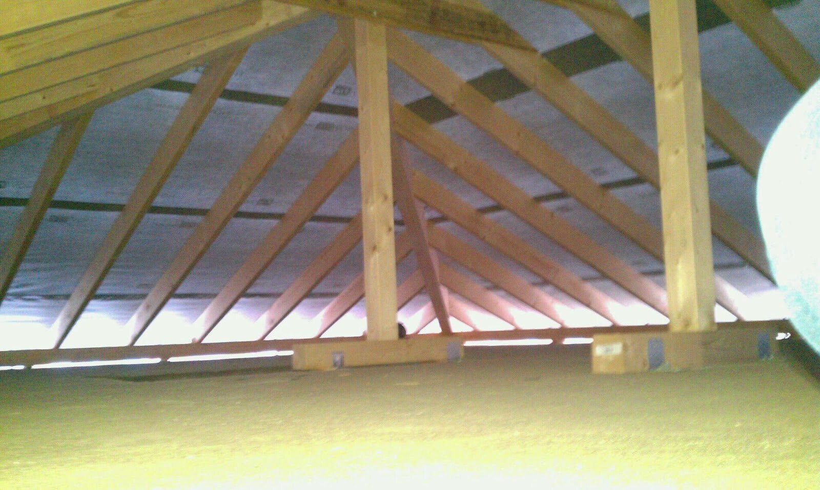

can someone tell me what this construction is called?
Wooden roof frame with visible rafters and beams in the attic
It’s not a prefabricated truss, right?

That was just an example; I’m not specifically attached to a trussed roof or anything. Somehow, I actually tend to prefer roof structures like the one shown in the picture I provided above. Based on what you’ve said, I assume that trussed roofs used to be more cost-effective but that this has more or less evened out now? And that a trussed roof costs about the same as a traditional purlin roof frame?

Can you give an approximate difference in cost? Just so there’s a rough idea. Of course, it probably depends on the region, but it’s only meant as a general reference. Maybe the difference is so large that it doesn’t fit the budget at all.
We don’t plan to convert the attic into living space, but for storage purposes, a traditional rafter roof structure would be much better than a truss roof with all those wooden beams.
