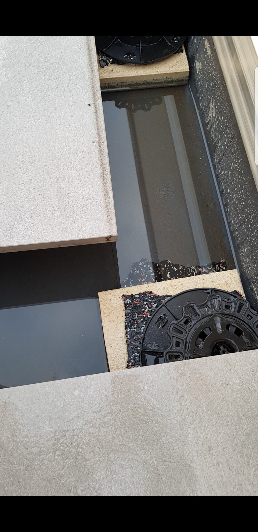

We have a rooftop terrace in our new build.
The base is concrete. After that, I’m not sure what layers come next, but there is definitely an insulation layer. All of this is beneath a sealed membrane (I’m not sure what material this membrane is made of). There are drainage openings to allow rainwater to flow off, and there is also a slight slope.
On top of this membrane, pavers were installed using pedestal supports. Under each pedestal is a piece of matting (similar to the kind used under gym equipment), then a stone slab, and on top of that stone slab another piece of matting. The tiles you see are then installed continuously on top of this.
Today I removed two of these tiles to take a look underneath. It has rained heavily over the last two days, but not today. What struck me as odd is that there was quite a bit of standing water visible, which drains very slowly or not at all.
Is standing water problematic? Could it freeze in the worst case or damage the membrane?
Or is this completely normal and harmless?
The site management said in summer, before handover, that this is not a problem—the water will evaporate, and having some standing water is totally harmless for the materials.
One of the mats under the surface was even floating in the standing water...
Could this possibly be a defect and still considered a fault to report (if that is still possible)?

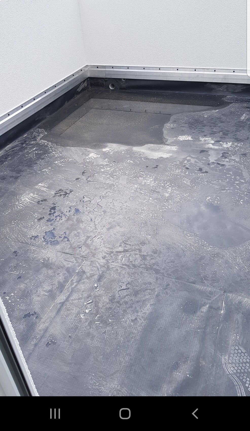

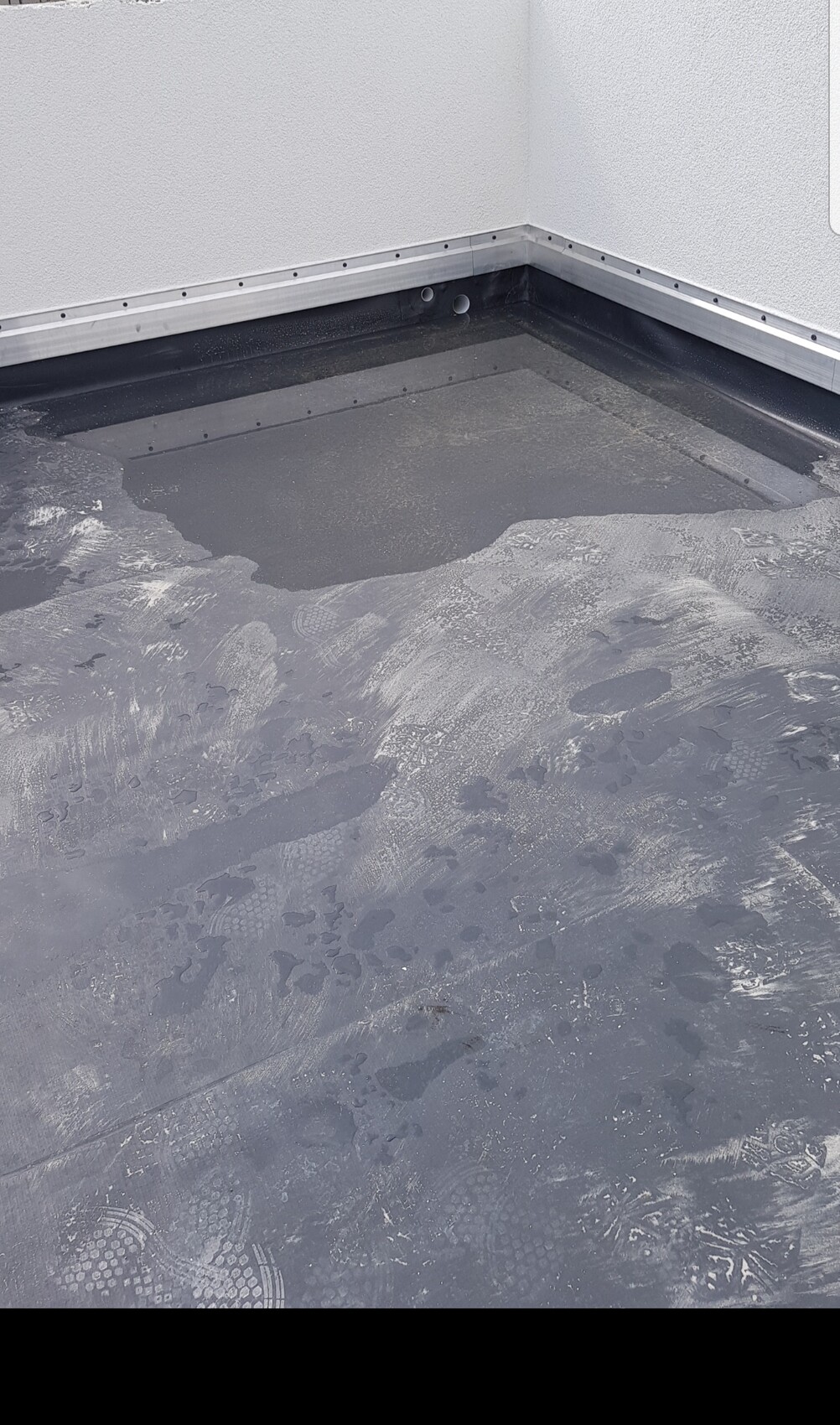

Corini198522 Dec 2019 09:30Exactly, the openings refer to the drainage system.
The entire setup was designed with two drainage points, each located at the corners.
The mats are only installed at specific points.
Before everything was installed, some water was already pooling.
I questioned this several times. Then, as mentioned, the explanation given was that the water would evaporate. Since it was midsummer, the water did indeed evaporate quickly each time. Now, however, there have been several days of heavy rain.
I have attached some photos from the summer...
Thank you.
Do you consider this a defect?
Thank you.
