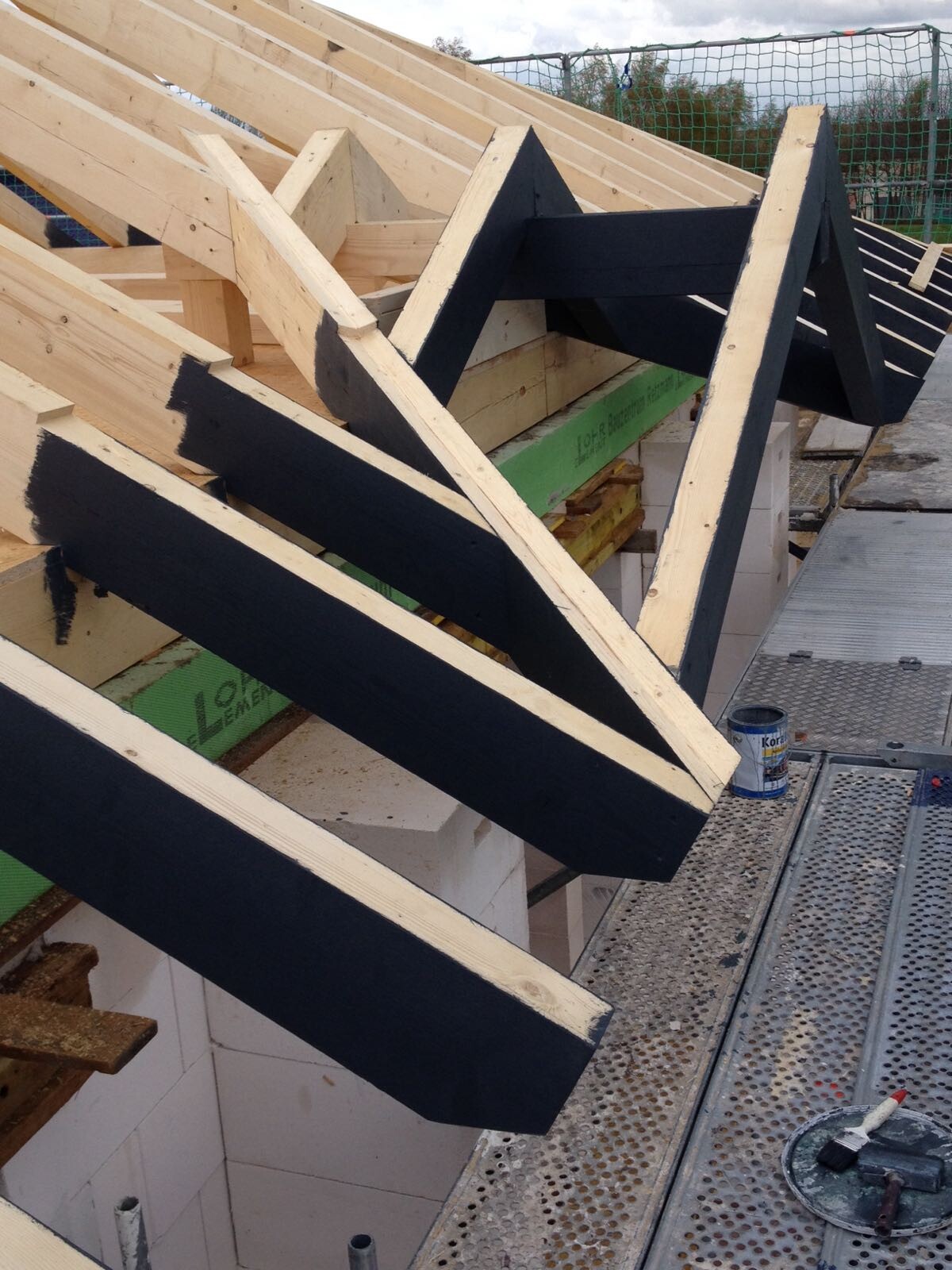

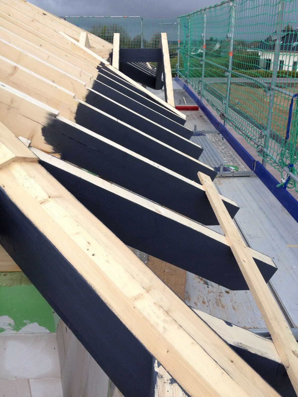

we also really wanted to keep the rafters exposed and had them custom made like that by the carpenter. I have two pictures here that might help you.
The part that was painted on site by the carpenter is visible later on.

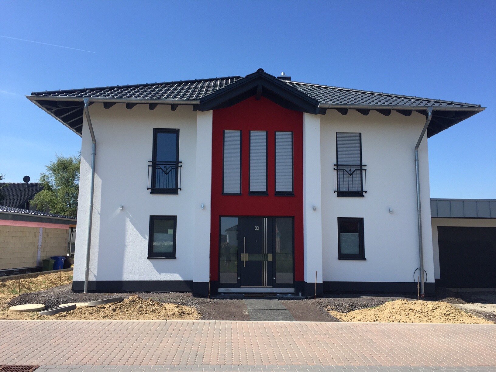

Our roof overhang is one meter (3 feet 3 inches). Even from a distance, the rafters are still clearly visible.
I have a few more pictures of the roof structure if you need any.

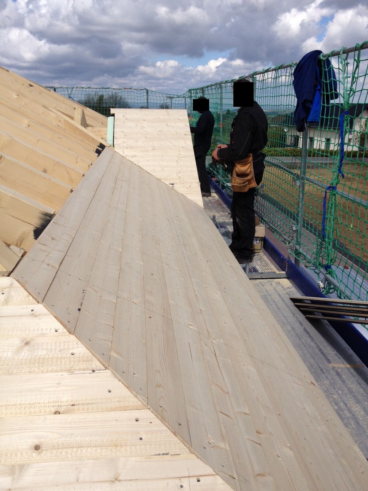

koettel892 Aug 2017 07:30@Invi85 Thank you for the quick response and the pictures.
What does the cladding look like? Is it screwed from above onto the rafters?
This is how I think it’s ideally done. For me, a proper roof overhang also means that you can see some of the construction in the roof. Otherwise, it somehow looks like it’s just “stuck on.”
Invi85 schrieb:
simply screwed from above Exactly, a small part of the rafter is removed according to the board thickness, and then the boards are nailed onto the visible section.
This was also done for us and is rather the standard method. Cladding is usually an extra feature that comes at an additional cost.
