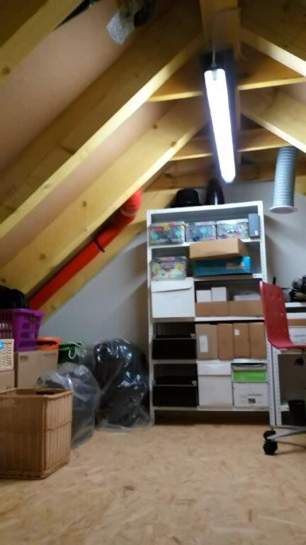

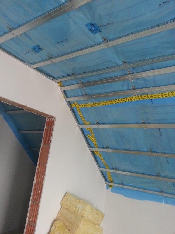

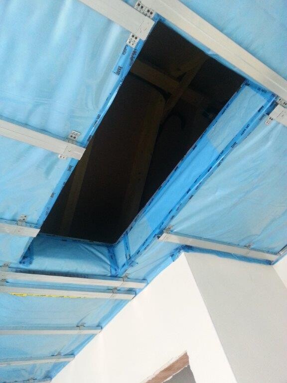

michael197815 Jan 2016 08:42Hello, the roof according to the building contract: made from structural timber grade II, impregnated, with Erlus E58 roof tiles, substructure made of Pavatex Isolar wood wool boards 35mm (1.4 inches).
Before the roof tiles were installed, a black membrane was rolled out. Inside the attic, you can see the insulation of the upper floor roof sections in the corners.
Attached are some pictures.
Regards, michael

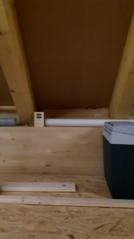

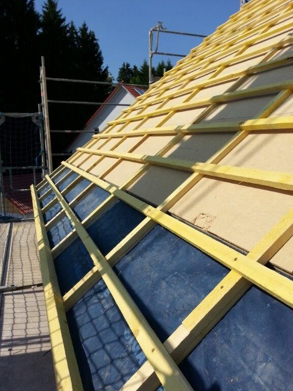

michael197815 Jan 2016 09:04Well, as the pictures show: roof structure, followed by Pavatex panels, then a battens framework for the roof tiles, and finally the roof tiles themselves.
From inside, you can only see the Pavatex panels in the attic – no membrane.
Attached is a picture of the roof from the outside, before the roof tiles were installed,
and two pictures of the attic ceiling.
