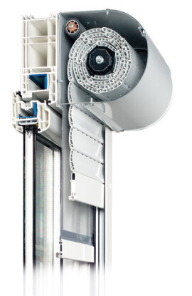

In contrast, the surface-mounted roller shutter box (also called exterior roller shutter box) is installed on the outside of the window frame and is usually visible.
Example photo:
Here the service/access panel is located on the outside.
In the drawing, the box is round; rectangular boxes are more affordable.
The advantage of this type is that it is cheaper and can be retrofitted relatively easily.
However, it is very rarely used in new builds.
An intermediate solution (with a good price/performance ratio) is a surface-mounted roller shutter with a plaster carrier board.
Here the shutter box’s access panel can be plastered on the outside and thus blends into the wall.
This works either with a lintel offset (the window is installed further inside) or if the external thermal insulation composite system (ETICS) is thick enough, the windows can be installed “normally” and then finished flush with the insulation.
It should be noted that the box size increases with the height of the window units (logical, as more shutter slats need to fit inside).
For new builds, I consider this option interesting because cost plays a significant role.
