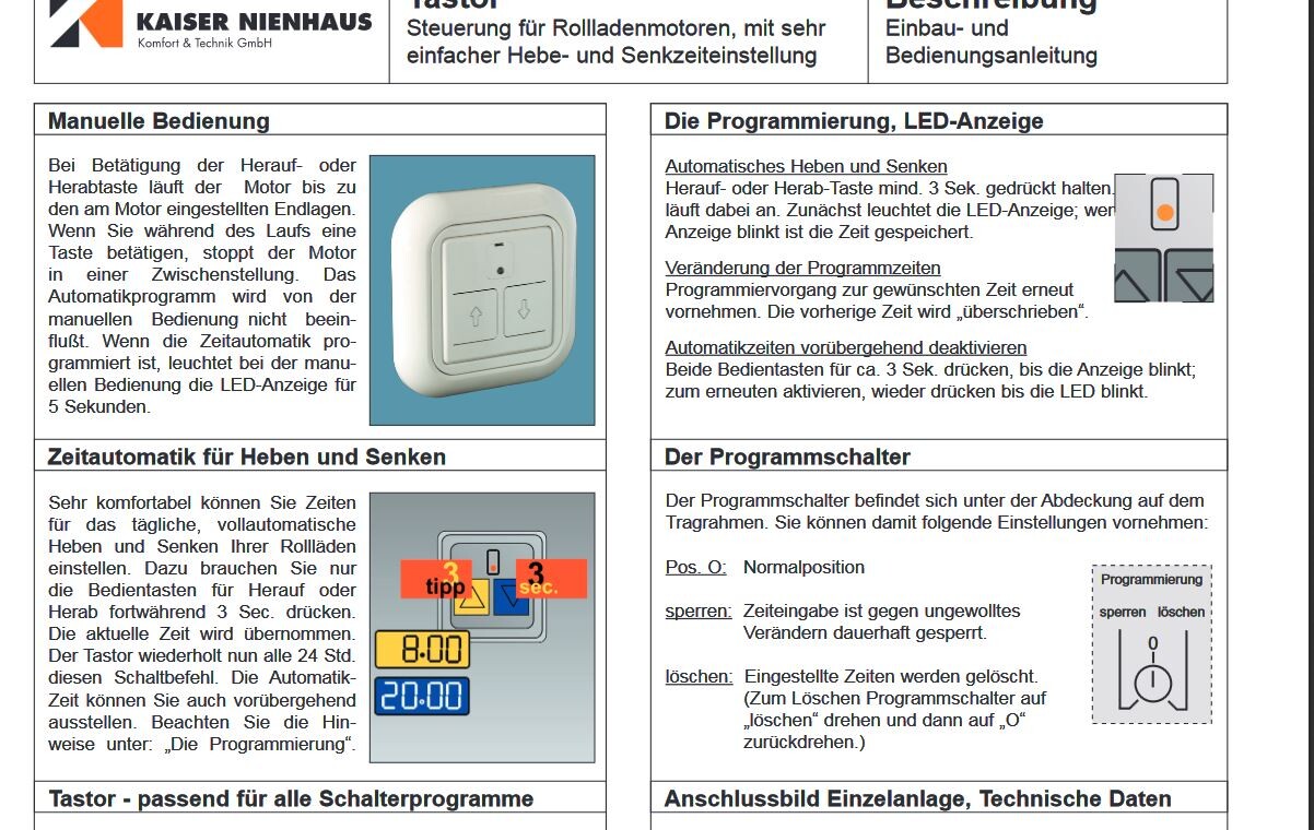

Replacing them without analysis is usually expensive. No, we don’t have any sensors. Even when the roller shutters are fully open, they sometimes roll down on their own. This rarely or never happens in good and especially dry weather. In wet weather or rain, they really act up—it’s quite a show...
Mycraft schrieb:
Has anyone here perhaps programmed the buttons for daily timed operation, either the residents or the installer?
Water ingress or something similar and a connection to the aluminum protective conduits is rather unlikely. The water would always have to close the same contacts. We have version 310000 – meaning without the option for timed programming on the individual switches. The central switch is in manual mode.
