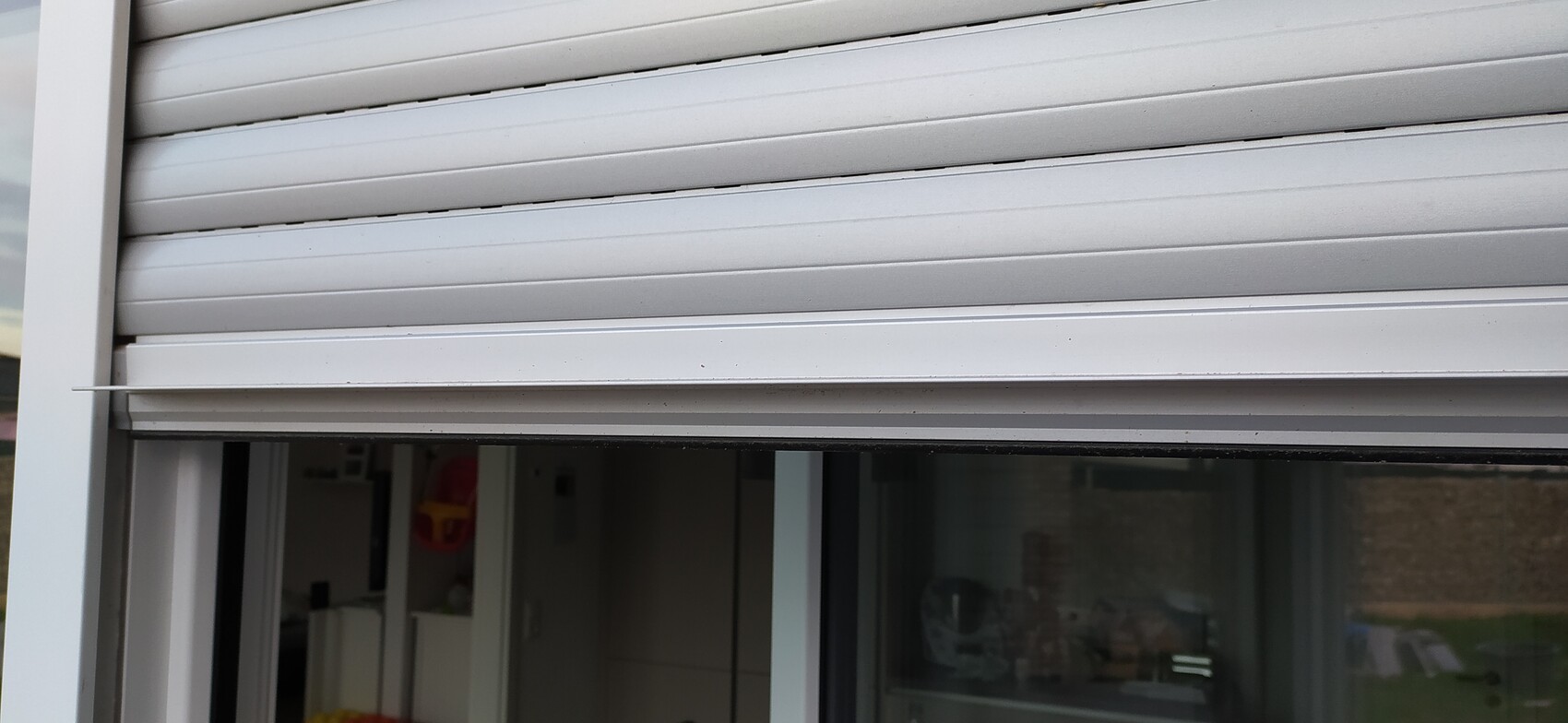

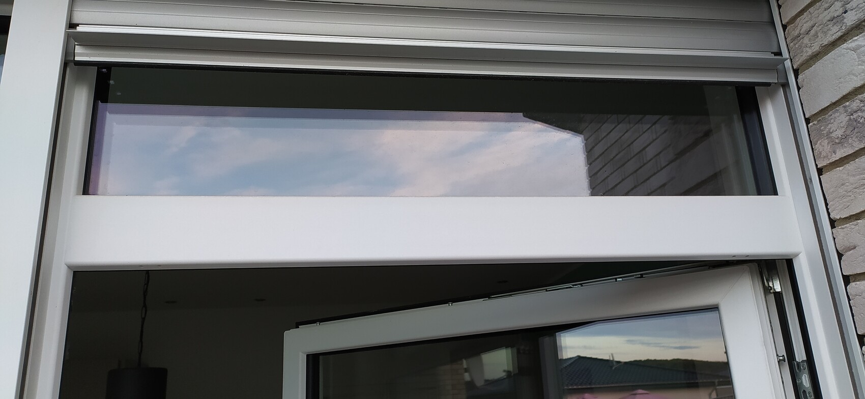

Request a two-part angled end rail.
We also installed these with our Somfy Oximo motors.
With electronic motors, you can’t avoid the stoppers or the rail.
Since they are two-part, you can easily unclasp them to, for example, replace the roller shutter slats or if something breaks with the motor and the shutter needs to be operated manually.
The rail is hardly noticeable.

I actually thought that a "stop strip" was standard nowadays. We have it installed too, and I never really gave it a second thought 😀
