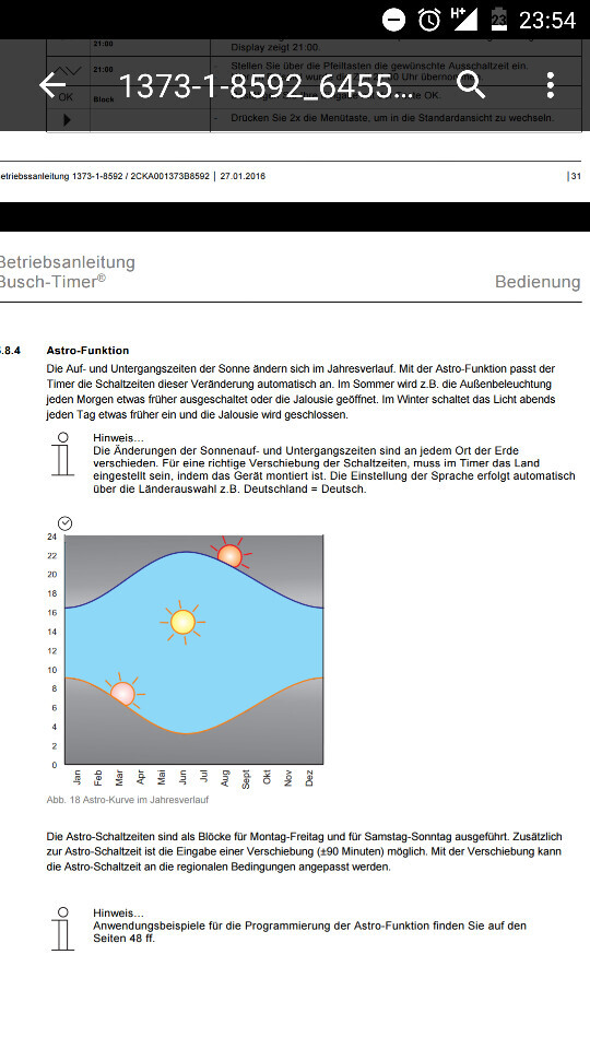

Regarding the GIRA, I also learned that Würzburg is fixed, and the offset can be adjusted by +/- 2 hours.
Something similar might be possible with the Busch-Jäger device as well; at least, according to the description above, you can only set the country there.
According to a customer response on Amazon, the Rademacher uses the first two digits of the postal code, allows separate blocking times for mornings and evenings, and also offers an offset.
So, they’re all quite similar and it seems more like a matter of preference.
