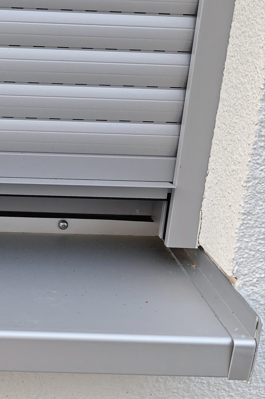

our roller shutters do not completely block out the light.
I have now noticed that although the shutter closes down to the aluminum window sill, the guides do not extend onto the window sills, leaving a gap on the side through which a significant amount of light comes in.
In another house, I saw that the guides run down onto the window sills and are therefore completely light-tight.
Attached is a photo.
Is this installation correct, or are the guides too short?
These are aluminum roller shutters, in a prefab house.
What do the experts say?

nordanney24 Jun 2025 10:14Mahri23 schrieb:
Someone didn’t measure correctly.The measurements were done correctly. However, the end pieces were not notched out. It also depends on the contract regarding which installation was agreed upon. You won’t be able to fix this properly afterwards.

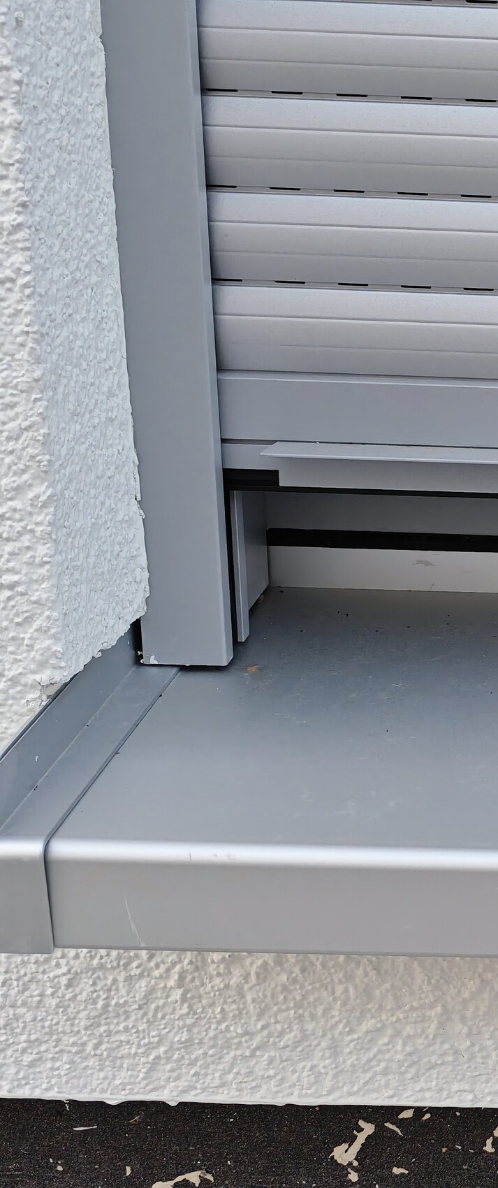

Maulwurfbau24 Jun 2025 10:26Interestingly, they did it "wrong" or rather correctly in one place by accident, and now they want to adjust the rest to match.
In my opinion, it should be done like this everywhere. I also don’t see what else would need to be ordered or commissioned. The trim should go all the way down and that’s it; technically, there is no other option except to make it too short.

Maulwurfbau24 Jun 2025 10:36The construction company says it has to be this short to prevent water from accumulating there.
So, what is actually correct?

nordanney24 Jun 2025 10:48Ah, it looked like a sliding piece in the other picture:
The roller shutter then ends on the end piece (used with external wall insulation systems) and needs to be notched out so that the roller shutter stops at the windowsill.
So, I agree with you. The guide rail is too short. Possibly you can adjust the roller shutter slightly as a temporary solution.
The guide rails are usually slid on. This can only be fixed (by using a longer guide rail) if the window is completely removed.
