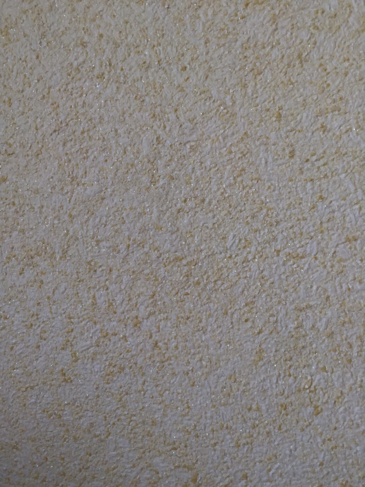

Is it possible to spray or tint it before applying?
No. It comes in multiple color combinations, available in fine and coarse grains, in a bag that covers about 3.3 m² (35.5 sq ft)…
see pm

I like it. Is it easy to work with? Can you really just make one piece and keep adding on? Are there differences in quality? And do the recommended quantities match the specified coverage areas? For paint and textured roller finishes, the given amounts are never enough.
driver55
3 Jul 2022 00:45
motorradsilke schrieb:
I like it. Is it easy to work with? Is it really true that you can just apply a section and then continue again later? And are there differences in quality? Also, do the recommended quantities match the coverage areas? For paint and textured roller plaster, the indicated amounts are never enough.
4x. Yes.
