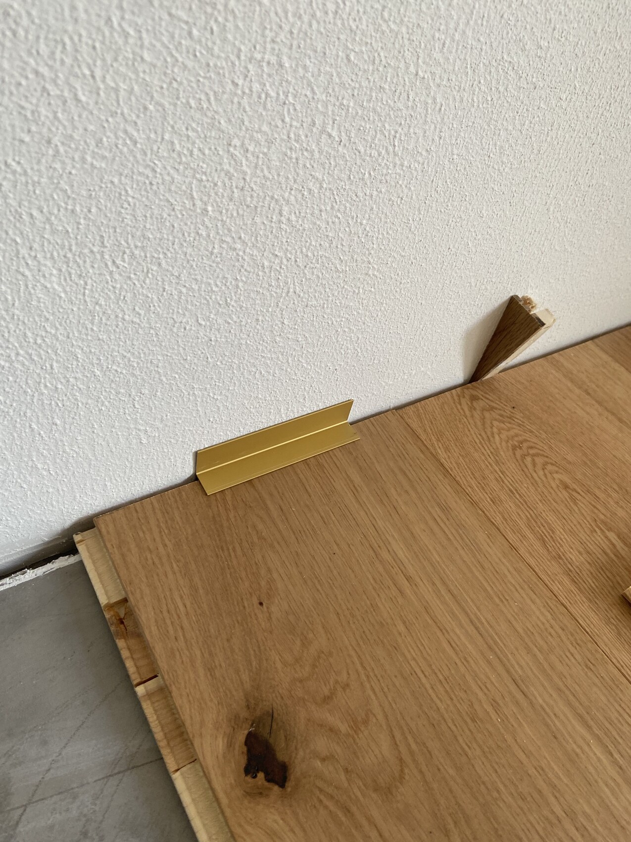

Professionals would start at the top and work their way down.But don’t use EasyPutz. 😉 I keep saying it here—the stuff is no good. I used it in a small office. After a few years, the color was gone or completely different. Also, it feels rough and sharp when you run your hand over it…I found a picture of the baseboard sample (it won’t be gold, though 🙂).
You can see the texture quite clearly here.
We primed with Knauf primer first, then applied it with a roller, and finally rolled over it with a finisher roller. We like the look, but it feels very much like sandpaper.
So we repainted everything white, and now the surface is "smoother." I can share a photo of that later. This picture shows the unpainted version.
We tested it beforehand in the bedroom behind the future wardrobe.
