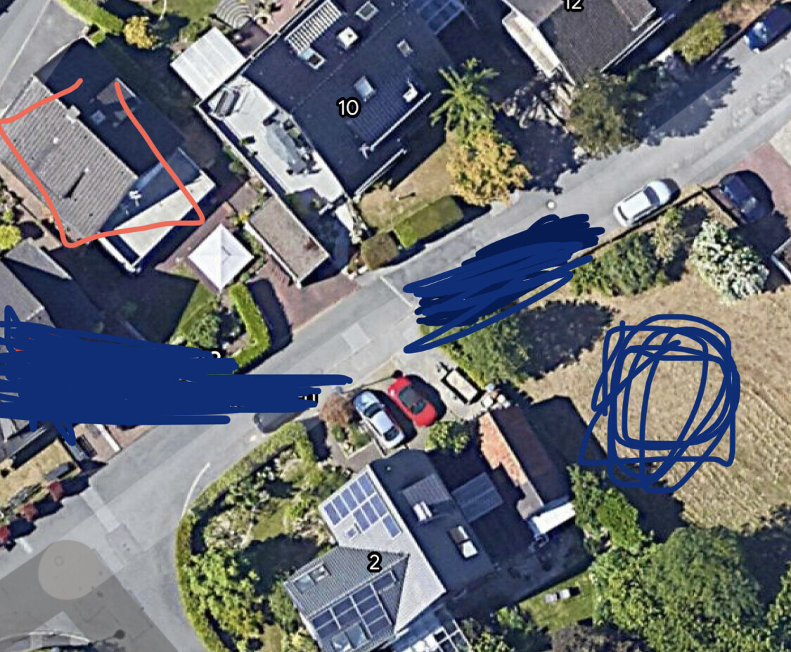

However, since you have professional experience, or anyone else here:
Would it be possible to place the crane on the blue circle and then lift the house over to the red area? Or is that too far and thus too heavy?

The first person responsible for assessing the duration/length of the required space is the construction manager, who then applies for the building permit / planning permission from the municipality / city in a timely manner!
@moooooo32: The crane cannot be 25 m (82 feet) away from the "house."
In addition, it must be considered that alongside the crane area, the truck carrying the prefabricated components must be parked in close proximity.
