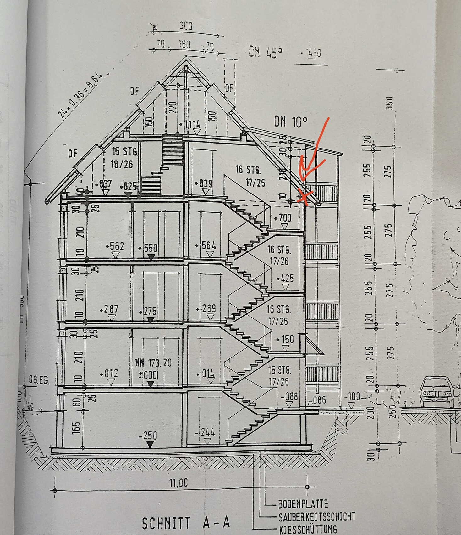

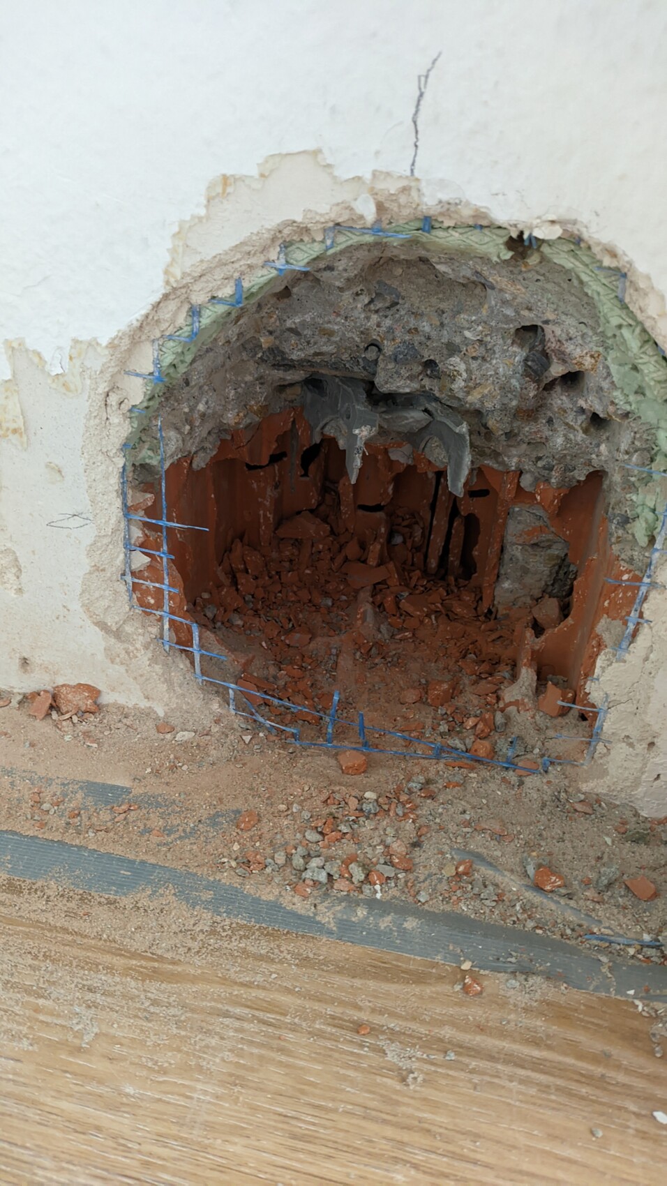

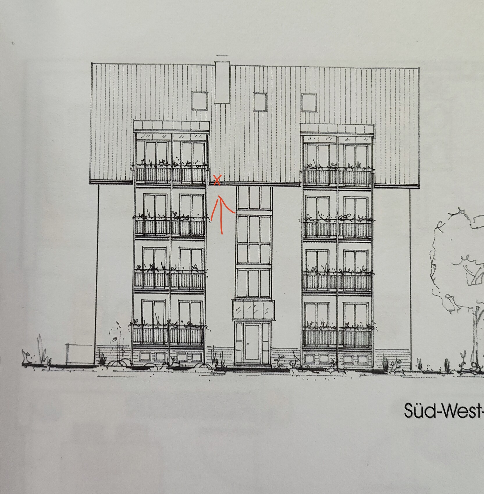

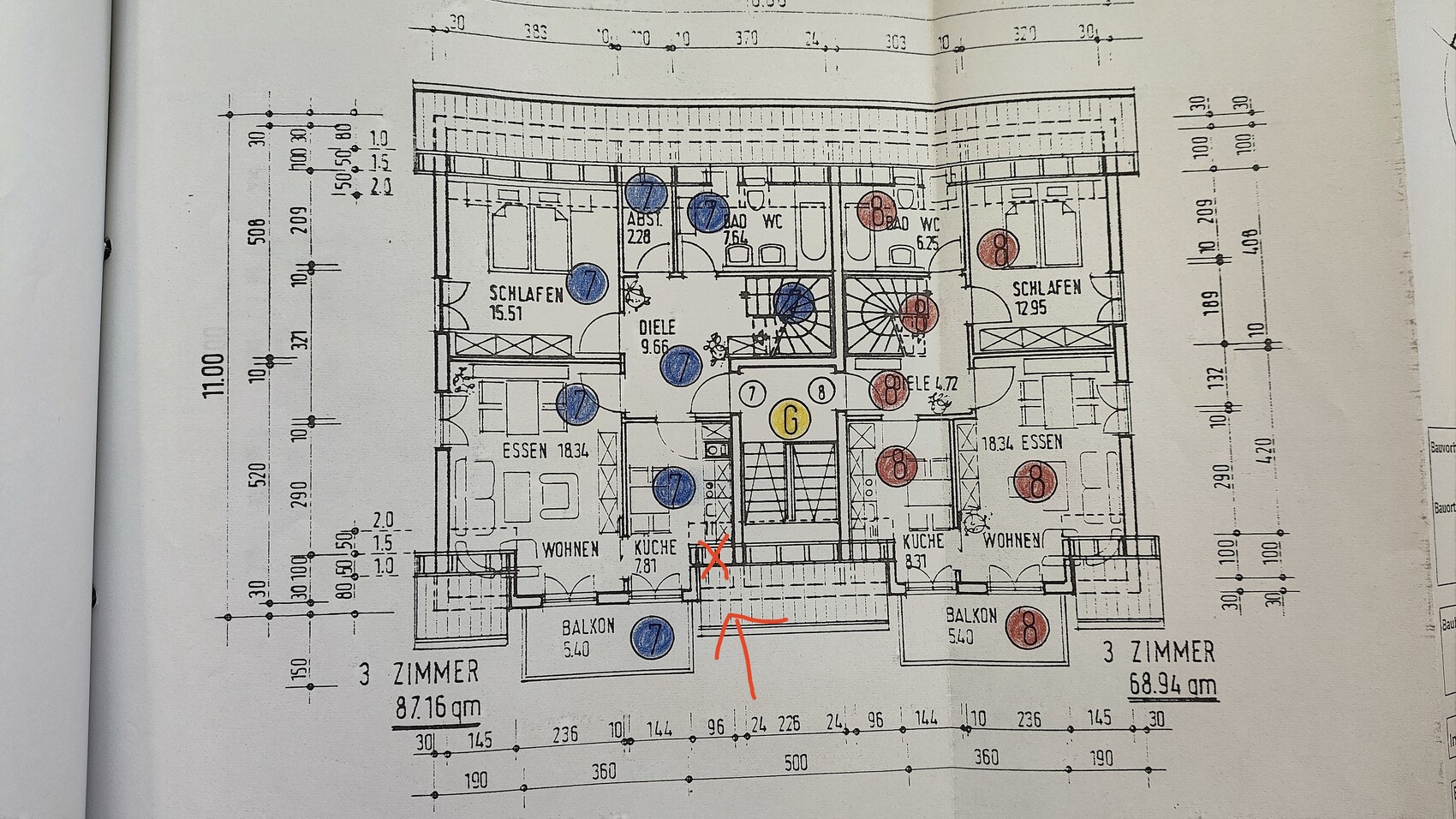

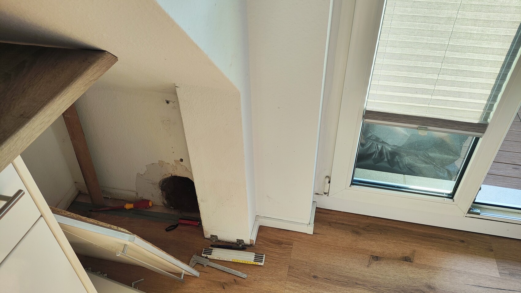

Hello everyone, I urgently need some help. While drilling a core hole for an exhaust vent in the knee wall, I accidentally cut through two reinforcement bars. Now I’m worried that this might affect the structural integrity. Can I chisel out the old reinforcement and reconnect it with new reinforcement using bonding mortar? Here are some additional details: the hole went through two layers – the lower half in brick, which I suspect is hollow brick, and the other half in reinforced concrete. The drilling was done close to the floor. That means the bare concrete floor is just below 6cm (2.4 inches) of screed. Unfortunately, I don’t have a structural calculation, only the drawings from the building permit / planning permission application. I have attached them, with the drilling location marked by a red cross. So far, there are no cracks or damage near the drilling. Thank you in advance for your support!

These are 12mm (1/2 inch) rebar. I am concerned that exposing the rebar further might worsen the situation and cause cracks. Can you tell me the name of the tool?

What you haven't shown a picture of is the drill core; I don't see any reinforcement here. And in my assessment, you haven't drilled through any ring beam, but through the brick wall below.

I’ve received feedback from an acquaintance who works in construction. It’s probably a ring beam that distributes the loads from the stairwell, as there is only a window front in that area. He said it’s not a big issue because the ring beam is still supported well enough inside my apartment. He also mentioned that there should be enough steel reinforcement in the ring beam anyway. What are your thoughts on this?
