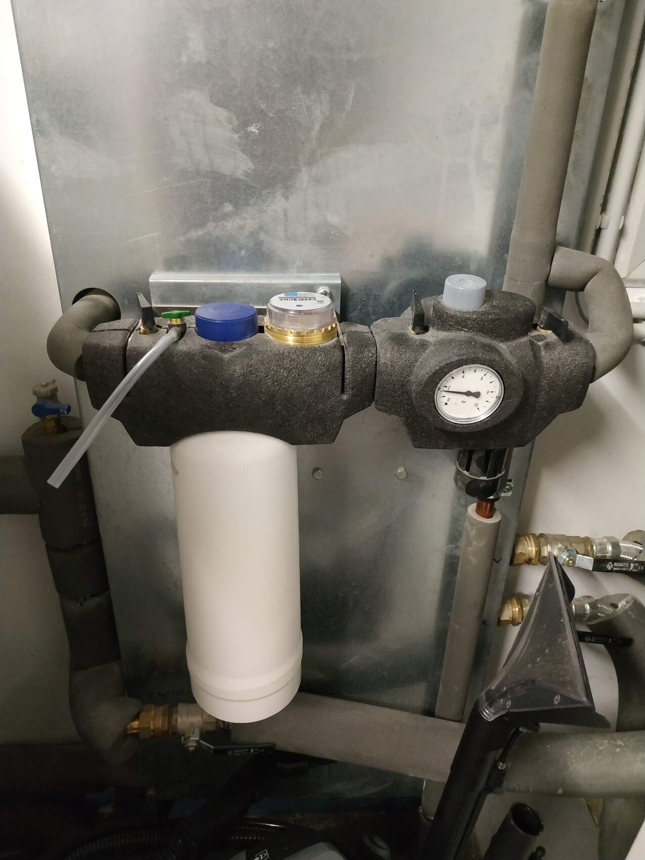

@tomtom79
Do you have a picture of how something like that looks in your setup?
@Mycraft
What exactly does this device do? I remember the plumber saying that if there’s a defect or something similar, the water gets tested or analyzed, and possibly the manufacturer might refuse warranty coverage if any negative results come up. At least, that’s how I recall it.
Or is it just an extra service offered by the plumber?
Thanks!
@Mycraft
Thanks!
This device is a water softener. It softens the water so it can be used in the heating system. Hard water in underfloor heating can cause damage. However, a properly installed system must use soft water anyway, which the plumber is responsible for ensuring. If the system needs to be refilled, the plumber should come with the necessary equipment and desalinate the water on site.
So yes, it is an extra task for them and for you, it provides an option to refill yourself. But ideally, you should not do this on your own, at least not during the initial period while the warranty is still valid.
